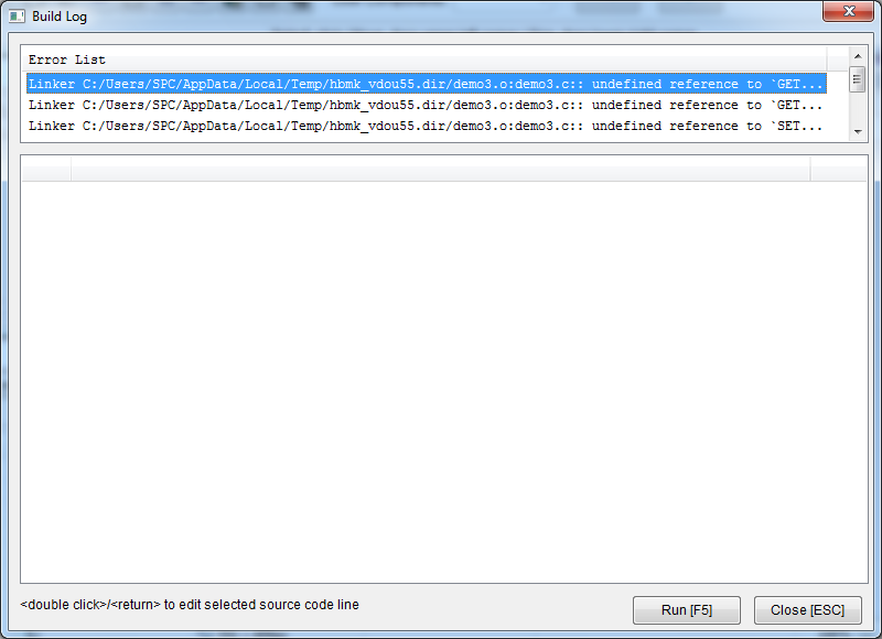

Hi Pablo
I am getting following error while compiling
Pls advice what is to be done.

Hi RPC
Patch it. See http://hmgforum.com/viewtopic.php?p=50240#p50217 for Pablo's answer.

RPC wrote: Fri Mar 24, 2017 5:05 pm I am getting following error while compiling
Hi Rajeev,
Probably you did not applied yet the two patches of 3.4.3 version as it said already Anand. (By the way: thank you Anand).
It's incomplete info in your screen captured.
As a result of this lack of visibility, let me know something:
have you already tested the ViewError - HMG building utility ? For me it's useful, if not for you may you tell me what did you dislike about it ?
