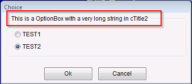

I have a small improvement for your fantastic OptionBox. When the lenght of the parameter cTitle1 or cTitle2 is longer than the length of the longest parameter in the array aOptions, cTitle1 or cTitle2 is not displayed right. For example:
OptionBox("Choice","This is a OptionBox with a very long string in cTitle2",{"TEST1","TEST2"}, 2)
2017-02-04 17_59_29-OptionBox - LongTitle.png (5.14 KiB) Viewed 4622 times
This can be solved by adding 2 lines of code:
nWidth:=iif(nWidth<GetTextWidth(NIL,cTitle1,FontHandle),GetTextWidth(NIL,cTitle1,FontHandle),nWidth)
nWidth:=iif(nWidth<GetTextWidth(NIL,cTitle2,FontHandle),GetTextWidth(NIL,cTitle2,FontHandle),nWidth)
Now the result is:
2017-02-04 17_59_29-OptionBox - LongTitle 2.png (4.43 KiB) Viewed 4622 times
I included the modified version as an attachement.
