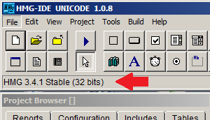

bonsoir tout le monde
attention il faut reconfigurer le fichier IDE (parametres de configuration )de l'IDE ,car il ouvre le fichier du hmg 3.40
Merci de votre partage et bonne suite à tous
Attention must reconfigure the Hmg IDE (configuration settings )file, because it opens the file hmg 3.4.0 instead of 3.4.1
Best regards
Best regards

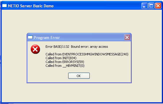

Hi All,
I'm creating a basic NETIO server with 3.4.1 and I've got an error:
Build: 32 Bits
OS: XP SP3 32 Bits
Configuration: -mt (multi-threaded)
The code that generates the runtime error is the following:Error BASE/1132 Bound error: array access
Called from EVENTPROCESSHMGWINDOWSMESSAGE(6782)
Called from INIT(838)
Called from ERRORSYS(59)

Thank you for advising.tonton2 wrote:Attention must reconfigure the Hmg IDE (configuration settings )file, because it opens the file hmg 3.4.0 instead of 3.4.1
Will need to re-edit C:\hmg.3.4.1\IDE\hmg.ini file (you can use Notepad++) to set right hmgpath.
Also you would check C:\hmg.3.4.1\IDE\editor.ini file. I do not know if mine was the only wrong path of Notepad++ or came wrongly setted.

Este error en tiempo de ejecucion, parece que empezó a ocurrir desde la version hmg.3.3.1.Roberto Lopez wrote: Error BASE/1132 Bound error: array access
Called from __HBVMINIT(0)
Hé testeado con versiones anteriores.
El accionar del EventProcessHMGWindowsMessage en el Init.prg empezó justamente apartir de hmg.3.3.1.
Espero que la información sirva para resolver el problema.

Thanks Roberto for report.Roberto Lopez wrote:Hi All,
Build: 32 BitsCode: Select all
nPort:= 50000 cIfAddr:= '0.0.0.0' cRootDir:= '.' lRPC:= .T. cPasswd:= 'secret' nCompressionLevel:= 9 nStrategy:= NIL pSockSrv := NETIO_MTSERVER( nPort , cIfAddr , cRootDir , lRPC , cPasswd , nCompressionLevel , nStrategy ) if empty( pSockSrv ) MSGSTOP("Can't Start Server!") RETURN endif
OS: XP SP3 32 Bits
I fixed, please unzip this file in folder c:\hmg.3.4.1\SOURCE and re-build the lib.
- h_Event.rar
- (43.29 KiB) Downloaded 405 times

After apply of above patch, Server compilation Ok, but run time error

Hi Dave,
Certainly you doing something wrong or missing something.
I've applied the recently patch given by Claudio replaced files at source folder and re-builded libs and all working properly.
Except second button to stop server due missing variable.

Thanks Claudio!srvet_claudio wrote: Thanks Roberto for report.
I'll try it and report back.

It works perfect. Thanks Again!srvet_claudio wrote: Thanks Roberto for report.
