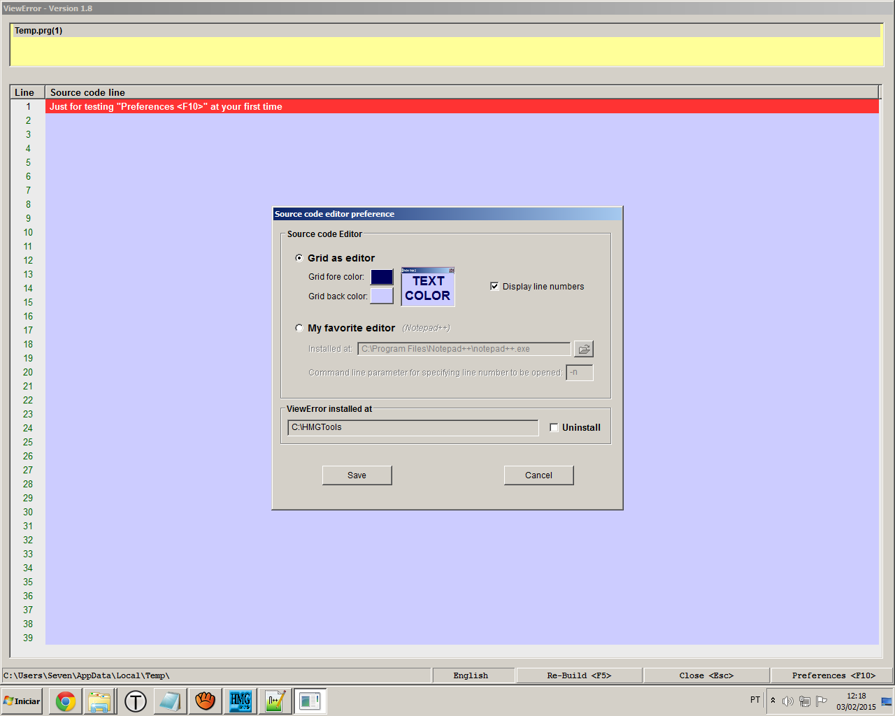

    2. The you will see this screen:
      In this step, you can set your favorite source editor by selecting executable file (Notepad++ is our indicated source editor). If you do want to work with any editor, you can choose for Grid option just for displaying the error line in your source code when any error occurrs during building process. Different colors for Grid can also be selected. But I prefer to work with my favorite source editor (Notepad++). One op below is where ViewError will work (after booting system) and you can clik in Save button just to confirm installation and save INI configuration file.

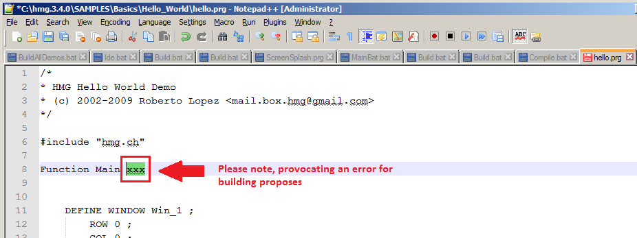

    1. Let's provocate an error first at one Demo in SAMPLES taking this C:\hmg.3.4.0\SAMPLES\Basics\Hello_World as example.
    2. Re-edict C:\hmg.3.4.0\SAMPLES\Basics\Hello_World\hello.prg and write any thing at line of Function Main as for example:
    3. Save this prg and try to build this demo click at IDE's Run button or pressing F5 at IDE.

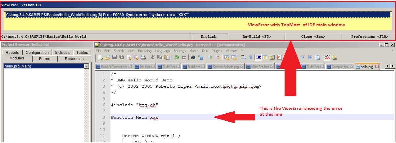

    4. You will see instantaneally be displayed this:
      Please note this when favorite source editor were defined

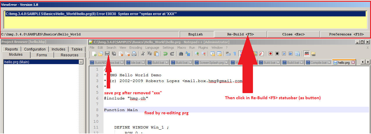

    5. You can fix the prg where the error was positioned and Rebuild at this button:

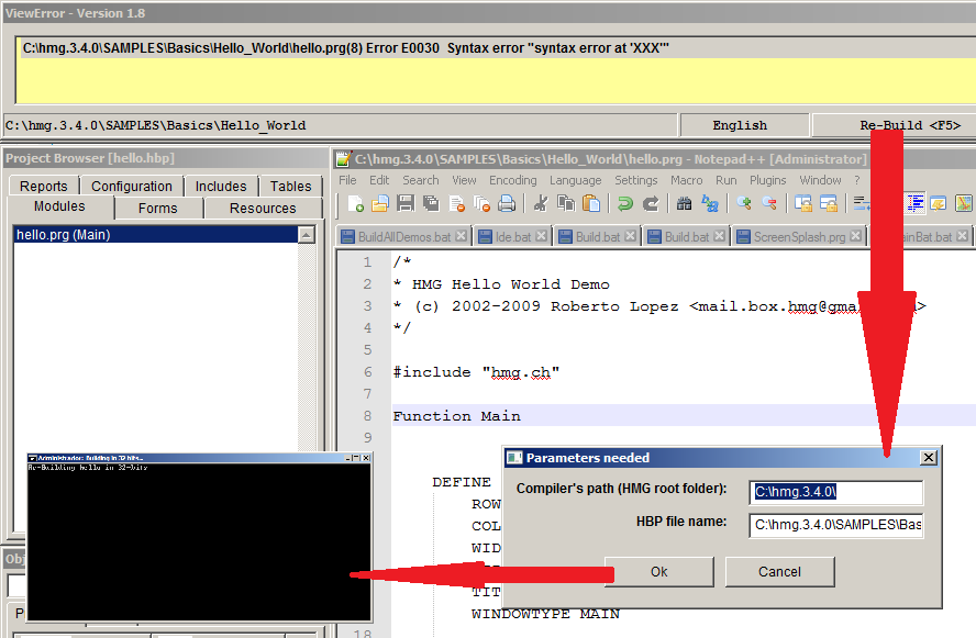

    6. After saved and clicked at Re-Build will be displayed this:
      For confirming HMG version and HBP file.
    7. When confirming OK will start re-Building hello demo as you can see black window. And finish the building process will run Hellow word !

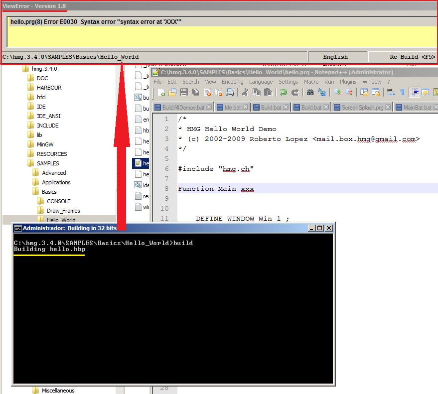

  • B. Build thru command prompt (at DOS), by line commands.
    1. Let's provocate same error as previous item at C:\hmg.3.4.0\SAMPLES\Basics\Hello_World as an example.
    3. Save this prg and go to Command Prompt at that folder and type:
      Build <Enter> then you will see this when the error has found:
      Items 5, 6 and 7 can be proceed like as the previous message. It's same procedure.
