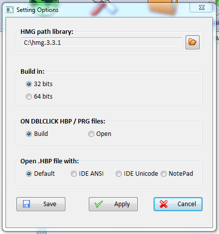

Now, another suggestion :
Settings suggestion
Settings suggestion
PROCEDURE SETTING_OPTIONS
LOCAL nWidth, nInc := 20, cFolderHMG_aux := cFolderHMG
   DEFINE WINDOW Form_2;
         AT 0,0;
         WIDTH  420;
         HEIGHT 450;
         TITLE 'Setting Options';
         ICON  '';
         MODAL;
         NOSIZE
      ON KEY ESCAPE ACTION ThisWindow.Release()
      nWidth := Form_2.ClientAreaWidth
      @ 20, nInc        FRAME   Frame_1  CAPTION "HMG path library:" WIDTH (nWidth - nInc*2)      HEIGHT 50 BOLD
      @ 40, nInc + 10   TEXTBOX Text_1   VALUE   cFolderHMG          WIDTH (nWidth - nInc*2 - 50) HEIGHT 20 READONLY
      @ 35, nWidth - 55 BUTTON  Button_1 PICTURE "_open_folder"      WIDTH  30                    HEIGHT 30 ACTION (Form_2.Text_1.VALUE := SETTING_Folder(), cFolderHMG_aux := Form_2.Text_1.VALUE)
      @ 100, nInc      FRAME      Frame_2       CAPTION "Build in:" WIDTH (nWidth - nInc*2) HEIGHT 80 BOLD
      @ 120, nInc + 20 RADIOGROUP RadioGroup_1  OPTIONS {'32 bits','64 bits'}  VALUE nBuildBAT
      @ 200, nInc      FRAME      Frame_4       CAPTION "ON DBLCLICK HBP / PRG files:" WIDTH (nWidth - nInc*2) HEIGHT 60 BOLD
      @ 220, nInc + 20 RADIOGROUP RadioGroup_3  OPTIONS {'Build','Open'} VALUE 1 HORIZONTAL
      @ 280, nInc      FRAME      Frame_3       CAPTION "Open .HBP file with:" WIDTH (nWidth - nInc*2) HEIGHT 60 BOLD
      @ 300, nInc + 20 RADIOGROUP RadioGroup_2  OPTIONS {'Default','IDE ANSI','IDE Unicode', 'NotePad'} VALUE nOpenHBP HORIZONTAL SPACING 90
      @ 360, nInc BUTTON  Button_2 CAPTION "Save"   PICTURE "_save"   LEFT  WIDTH 100 HEIGHT 30  ACTION (SETTING_Save (cFolderHMG_aux), Form_2.Release)
      @ 360, 165  BUTTON  Button_3 CAPTION "Apply"  PICTURE "_check"  LEFT  WIDTH 100 HEIGHT 30  ACTION (cFolderHMG := cFolderHMG_aux, nBuildBAT := Form_2.RadioGroup_1.VALUE, nOpenHBP := Form_2.RadioGroup_2.VALUE, Form_2.Release)
      @ 360, 295  BUTTON  Button_4 CAPTION "Cancel" PICTURE "_cancel" LEFT  WIDTH 100 HEIGHT 30  ACTION Form_2.Release
   Form_2.Button_4.SetFocus
   CENTER WINDOW Form_2
   ACTIVATE WINDOW Form_2
Re: HMG Easy Build
esgici wrote:Now, another suggestion :
Very Good!!!
