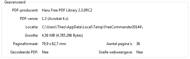

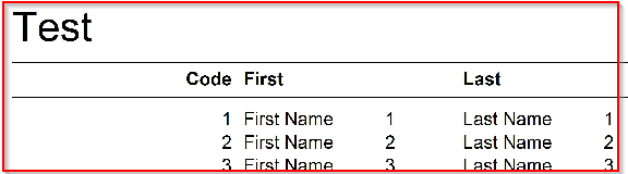

Here is the beginning of my PDF (with the original DBF).

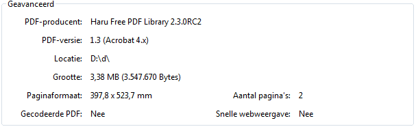

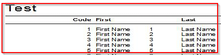

Now this is yours:
See the difference ? Also the properties are quite different, here are mine:
And your PDF:
See the differences in size and dimensions.
Maybe the papersize of the selected printer does make the difference ?
Theo

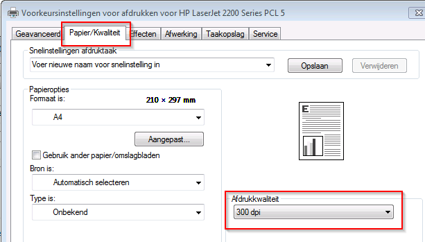

The selected printer makes the difference. Can you install the 'HP LaserJet 2200 Series PCL 5' in your system (even if you do not own such a printer, it is only for testing). The driver is in the standard drivers of Windows 7. Select this printer when starting my demo. When installed by default the resolution of the printer preferences is 600dpi and the error i described will occur. Now change the printing preferences of the printer to 300dpi and run the demo again. The PDF can now be created (but is is very big).
Probally your selected printer is a printer with a lower resolution than mine (and my customers).
