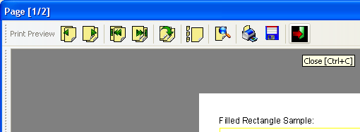

Actual with new RESOURCES:
(Exit image too black)
Would it be better to improve Exit button as before patches:
Please Claudio, explain what have you done on images. :?

Pablo César wrote:Actual with new RESOURCES:
The problem is the background color of the images, always the background color is the first pixel.
HMG 3.3.0 (Stable) Patch 1
Posted: Wed Jun 04, 2014 5:55 pm
Thank you for your explaination Claudio, now Exit button is perfect !
