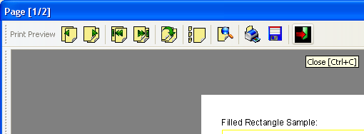

Actual with new RESOURCES:
(Exit image too black)
Would it be better to improve Exit button as before patches:
Please Claudio, explain what have you done on images. :?

Pablo César wrote:Actual with new RESOURCES:
The problem is the background color of the images, always the background color is the first pixel.
RESOURCES2.rar
(86 KiB) Downloaded 900 times
HMG 3.3.0 (Stable) Patch 1
Thank you for your explaination Claudio, now Exit button is perfect !
