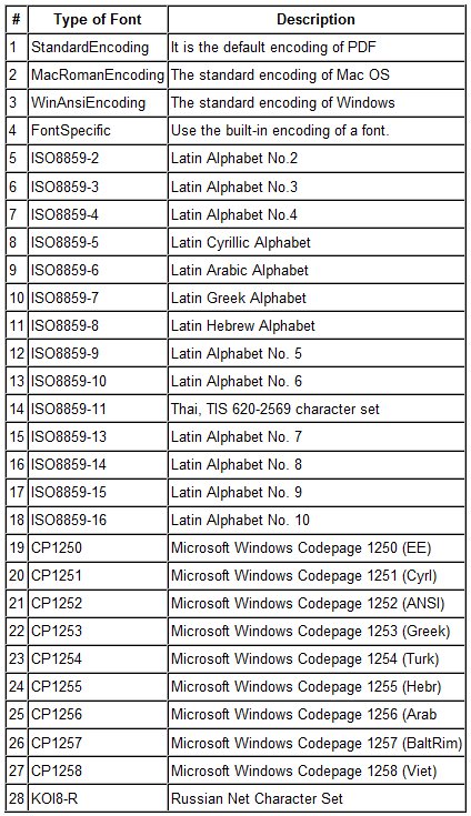

In this version we can encode the pdf with different character encodings:
The command is:
SET HPDFDOC ENCODING TO <cEncoding>
Example: SET HPDFDOC ENCODING TO "CP1254"
These are all the possible encoding options: (from the LibHaru Documentation)
Kindly check and tell as I am not well versed with these encodings.
rathinagiri wrote:...Kindly check and tell as I am not well versed with these encodings.
Checked for my own language; result is perfect as always :)
