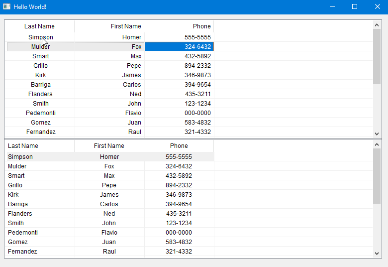

How can I set different tooltip for every row?
Is it the way to detect row pointed by mouse hovering and change tooltip depends on pointed (without clicking) grid cell?
Did anybody realized this?

mol wrote: Sat Jan 19, 2019 11:14 am How can I set different tooltip for every row?
I did not do it before, but I made this code especially for you ;) :

There is a different ToolTip for each cell, but you'll easy manage to get this effect for a different row ;) .

Re: how to catch mouse event in a grid ?
Changing tooltip for every row and column works perfect.
But now, I need to change fontname and fontcolor depend on column number.
I/'m trying code
		aFontWeather:= ARRAY FONT "Weather" SIZE 28
		SET TOOLTIPCUSTOMDRAW CONTROL GRID_Utargi OF FORM_Utarg FORECOLOR {0,0,128}  ARRAYFONT aFontWeather BALLOON .T. TITLE "WEATHER"
But it works only for first use.
I don't see any error in this code.
Can somebody

U mnie działa, włączyłeś SET TOOLTIPCUSTOMDRAW ON ?
Na moim Win 10 nie reaguje na FORECOLOR :?
It works for me, did you activate SET TOOLTIP CUSTOM DRAW ON?
On my Win 10 it does not respond to FORECOLOR :?
I've realized my idea. It's really strange with forecolor. In one column is set to green, but when I change in another column, it becomes black :-D
When I set title to empty string, then body of tooltip becomes red :)

Yeap. http://hmgforum.com/hmgdoc/data/SetTool ... omDraw.htm
- If the Title is specified the ForeColor property does not work.
It should work in your code:

			CELLNAVIGATION
		@ 250,10 GRID Grid_2 ;
			WIDTH 760 ;
			HEIGHT 240 ;
			HEADERS {'Last Name','First Name','Phone'} ;
			WIDTHS {140,140,140};
			ITEMS aRows ;
			VALUE 1 EDIT ;
			TOOLTIP 'Editable Grid Control' ;
			ON HEADCLICK { {||MsgInfo('Click 1')} , {||MsgInfo('Click 2')} , {||MsgInfo('Click 3')} } ;
                	JUSTIFY { GRID_JTFY_LEFT,GRID_JTFY_CENTER, GRID_JTFY_CENTER }
   		CREATE EVENT PROCNAME Grid_ToolTip()
	CENTER WINDOW Form_1
	ACTIVATE WINDOW Form_1
FUNCTION Grid_ToolTip()
LOCAL nHWnd := EventHWND(), aCellMouseOver, cCtrlName:="", cFormName:=""
LOCAL nIndex := GetControlIndexByHandle ( nHWnd )
LOCAL cCtrlType := IF( nIndex > 0, GetControlTypeByIndex (nIndex) , "")
LOCAL aFontList := { "Arial", "Juice ITC", "Webdings" }
LOCAL aFontWeather, aForeColor
STATIC aTT := {0,0}
IF cCtrlType == 'GRID'
	GetControlNameByHandle (nHWnd, @cCtrlName, @cFormName)
	aCellMouseOver := ListView_HitTest ( nHWnd , GetCursorRow() - GetWindowRow ( nHWnd )  , GetCursorCol() - GetWindowCol ( nHWnd ) )
	IF aTT [1] # aCellMouseOver [1] .OR. aTT [2] # aCellMouseOver [2]
		aTT [1] := aCellMouseOver [1]
		aTT [2] := aCellMouseOver [2]
		IF aCellMouseOver [1] = 0 .AND. aCellMouseOver [2] = 0
			SetProperty( cFormName, cCtrlName, "ToolTip", "")
			aFontWeather:= ARRAY FONT aFontList [ aCellMouseOver [2] ] SIZE aCellMouseOver [1] * 5
			aForeColor := { if (aCellMouseOver [2] = 1, 244, 0) , if (aCellMouseOver [2] = 2, 244, 0), if (aCellMouseOver [2] = 3, 244, 0) }
			SET TOOLTIPCUSTOMDRAW CONTROL &cCtrlName OF &cFormName FORECOLOR aForeColor ARRAYFONT aFontWeather BALLOON .T.
			SetProperty( cFormName, cCtrlName, "ToolTip", "ToolTip for Row=" + Alltrim(HB_ValToStr( aCellMouseOver [1] )) + " Col=" + Alltrim(HB_ValToStr( aCellMouseOver [2] )) + " Value=" + GetProperty (cFormName, cCtrlName, "CellEx", aCellMouseOver [1], aCellMouseOver [2] ) )
RETURN Nil
