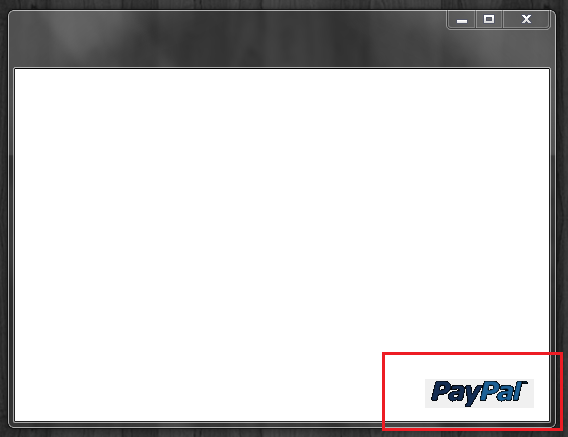

Re: HMG 3.2 (Stable)
Post by meneale »
This is how image with transparent property looks :|
AMD Phenom II X6 1090T 3.2GHz (OverClock 3.9GHz) | Windows 8.1 Pro 64-bit
4GB DDR3 | GTX 550 Ti 1GB | MSI 880GMA-E35
