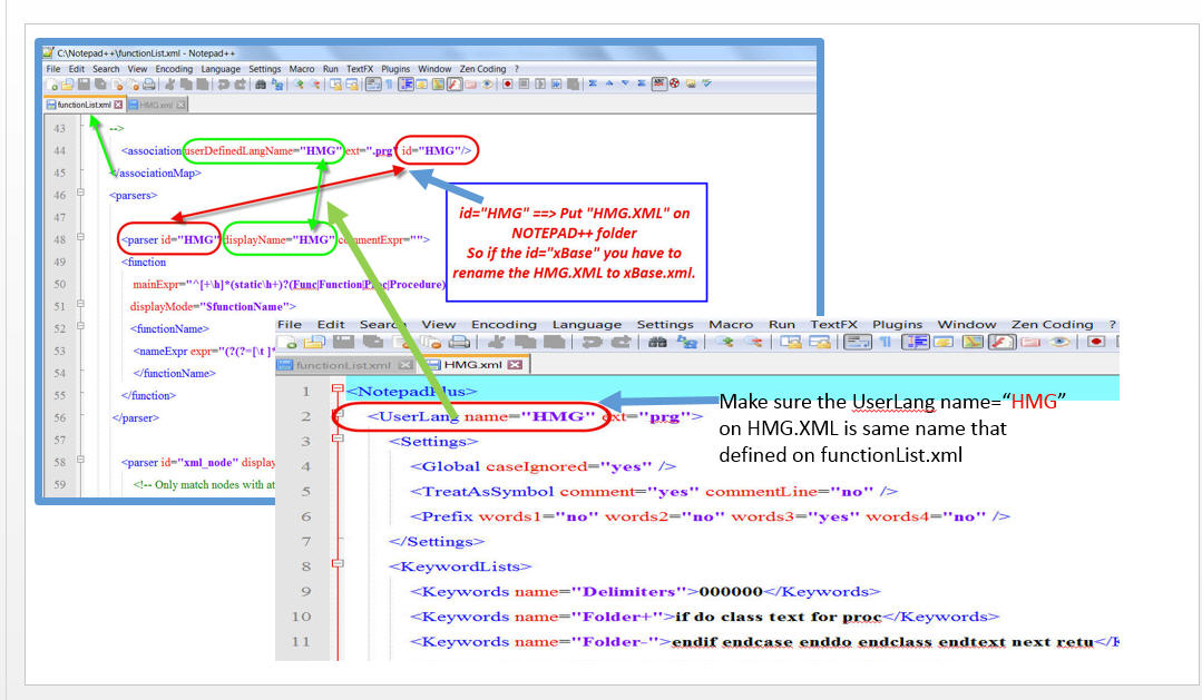

Hi Marc,
I do some modifications on your files, please unpack the attached file to the folder of notepad++. You might need to import the hmg.xml file again. Try to open a .prg file and if the function list is empty then select the "HMG" langauge file again and close the notepad++. Open again the prg file with notepad++ and click the icon of functionlist to "on" "off" this function. It should work. Good luck.
I think the relation between these two "xml" file is as below:
Re: Notepad++ Function List
Posted: Wed May 25, 2016 6:18 am
by TopsMarc
Hi Tiger,
It works ! Thank you very very much :D
Best regards, Marc
