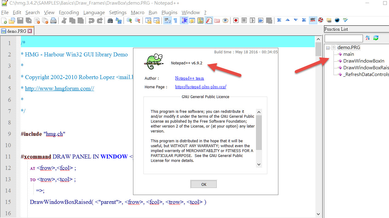

Hi Marc,
I do some modifications on your files, please unpack the attached file to the folder of notepad++. You might need to import the hmg.xml file again. Try to open a .prg file and if the function list is empty then select the "HMG" langauge file again and close the notepad++. Open again the prg file with notepad++ and click the icon of functionlist to "on" "off" this function. It should work. Good luck.
I think the relation between these two "xml" file is as below:
function_hmg.rar
(8.38 KiB) Downloaded 696 times

Hi Tiger,
It works ! Thank you very very much :D

Tiger
Posts: 74
Location: Taipei
Re: Notepad++ Function List
Post by Tiger »
Hi Y.TABET,
Do you try my suggestion to see if it works?
If you can get this function work on old version such as the 6.8xx, you can download the new version 6.9.2 with "zip" file and then unpack to a temporary folder. You can then copy all the files except the "functionList.xml" and paste them back to the folder of NOTEPAD++. I am using the new version 6.9.2 and I use this way to upgrade the NOTEPAD++ every time.

jayadevu
Posts: 240
Post by jayadevu »
Many thanks for the update.
Following 2 updates also need to be made:
1. If you prefix the function name with "Static": it does not show up in the function list.
2. Harbour Class and Methods also do no show up in the function list.
Hope one of the Gurus will chip in with their expertise.

Tiger
Posts: 74
Location: Taipei
Post by Tiger »
jayadevu wrote:Hi,
Warm regards,
Jayadev
Hi Jayadev,
Please try this ...
<parser id="HMG" displayName="HMG" commentExpr="">
<function
mainExpr="^[+\h]*(static\h+)?(CLASS|Func|Function|Proc|Procedure)[\t ]+[^\r\n]*$"
displayMode="$functionName">
<functionName>
<nameExpr expr="(?(?=[\t ]*)[\t ]*[\t ]+[^\s]+\w+[^\r\n]*)"/>
</functionName>
</function>
</parser>
