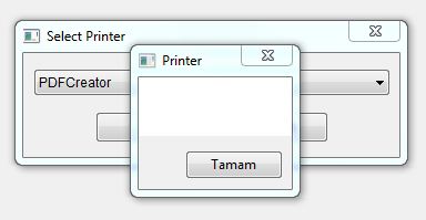

Version 3.1.4 GetPrinter function () works well
Version 3.1.5 GetPrinter function () does not work, that does not wait to make a choice
[u]Moderator Notes[/u] (Pablo César) wrote:Message moved from topic HMG v3.1.5 IDE error when changing default language.

maybe a little rushed and wrote the bug but this code does not work, the function does not return anything and appears error
   mPrinter := GetPrinter()
   If Empty ( mPrinter )
      msgexclamation("Printer is not selected ","Attention:")
      return NIL
   EndIf
Re: HMG 3.1.5 (Test)
dragancesu wrote:Version 3.1.4 GetPrinter function () works well
You are right !
GetPrinter changed behaviour in 3.1.5 version. In 3.1.4, working well.
Confirmed :(
We have a severe problem :(
PROC TestPrinter()
   LOCAL cResult := "What are happening ? "
   cResult := GetPrinter()
   MsgBox(  cResult, "Printer" )
RETU // TestPrinter()
Result of GetPrinter() testing
GetPrinter() terminating without waiting user response, and following msg function activated :?
