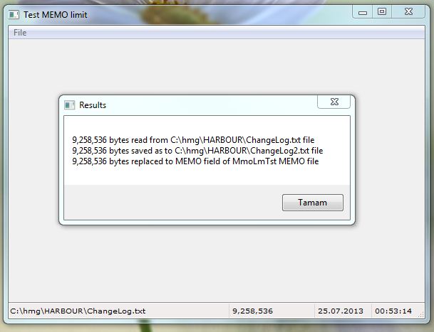

Hello Eduardo
EduardoLuis wrote: ...I've test your propousal, and the results was the same...
Try this once ...
Memo fields and text file limits test result
MmoLmTst.zip
Memo fields and text file limits test source files ( .hbp, .prg )
(1.44 KiB) Downloaded 977 times

Hi Eduardo
esgici wrote:
EduardoLuis wrote:... memowrit() only save 64kb...
Did you tried HB_MemoWrit() ?
Tried separately; no size difference found between MemoWrit() and HB_MemoWrit();
only difference is MemoWrit() added EOF marker ( CHR( 26 ) ) at end of output file.
