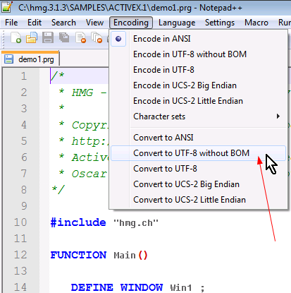

I want to know if there's a way to convert my programs code from ainsi
to utf8 automatically because i have more than 100 thousands line code in french
language , it's a job from 20 years written in clipper that i have changed to HMG
since 6 months
Foued

fouednoomen wrote: I want to know if there's a way to convert my programs code from ainsi
since 6 months
Insha-Allah Foued;
If our friend Dr. Soto will give us a function such as ANSIToUTF8(), we will write a program to convert ANSI ( .prg ) file(s) to UTF8 format.
I hope you already have converted your DOS prgs from OEM ( DOS format ) to ANSI ( Windows Format ) with HB_OEMTOANSI() function.
Or may be this is unnecessary for French language.
maasselam :)

fouednoomen wrote:Dear esgici ,
since 6 months
Foued
Foued :
Try with Notepadd++ Look here.
before make a backup
