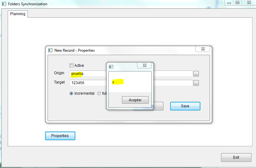

srvet_claudio wrote:
Steed wrote:Frist at all,I have to say many thanks.
Bud I have to report that the issue with the textbox control remained
Ed
Hi Ed.
Can you post a small example and describe the bug ?
Best regards,
Claudio
Hi, Claudio,
1- Run prueba.exe
2- Hit Properties button
3- Hit Save Button
Save button execute the next code:
cTemp:=GetProperty('Win2','Text_1a','Value')
msgbox(alltrim(cTemp)+"x")
But in a randomly manner the value is not returned, sometimes msgbox shows: "Pruebax"
And sometimes only shows "x"
Prueba.rar
(1.65 KiB) Downloaded 407 times
Thanks for your attention
Ed
Re: HMG 3.1.2 (Test)
Ed
Hi Ed.
Best regards,
Claudio
Hi, Claudio,
1- Run prueba.exe
3- Hit Save Button
Prueba.rar
Ed
I've compiled your sample with hmg 3.0.46 and 3.1.2. Everytime result of SAVE button was good.
Code is so simple, so I can't see any bug within.
Strange...
PS. One error was in line about 120 in procedure Get_Folders
before
SetProperty('Win2','Text_'+ntrim(Opz),'Value',cFolder)
after change
SetProperty('Win2','Text_'+ntrim(Opz)       + "a"      ,'Value',cFolder)
Marek
mol wrote: I've compiled your sample with hmg 3.0.46 and 3.1.2. Everytime result of SAVE button was good.
Strange...
before
after change
Marek
I also tested with HMG.3.1.2 (Win 7) and it worked fine with compile for ANSI and UNICODE.
