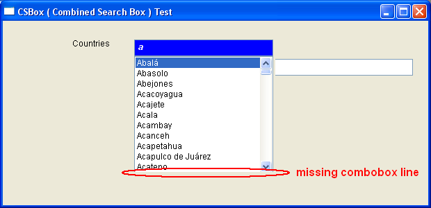

Regarding "missing combobox (box last) line" problem; I agree with you, we need correct this.
But please once look at combosearchbox.prg in HFCL lib; how many complex it is.
As a very little example, do you believe if I said: the combo box seen in the screen is not a real combo box, it is a list-box in fact; the search box isn't a real text-box it is a window in fact ?
Anyway I'll work on it too.
TIA :D

esgici wrote:the combo box seen in the screen is not a real combo box, it is a list-box in fact
I'm sure you will get the good ways to fix missing last line (at least in WinXP), probably by ISTHEMED case ??
