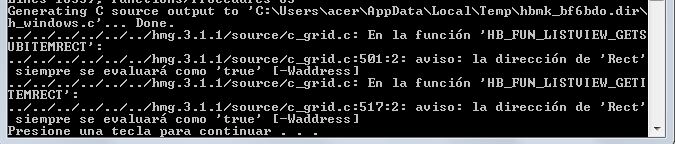

Mario Mansilla wrote:But I get several errors among others related to "TCHAR".
Now the library doing buildlib.bat as distributed while establishing lib gives an error message about "HB_LISTVIEW".
Hi Mario.
You could set the compiler messages?
I tested and not give me problem.
Best regards,
Claudio
PS: These two compiler warnings are "normal".
