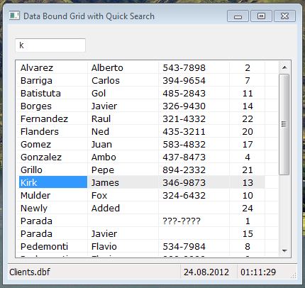

Hi All
I am a Clipper fan and I love Clipper lovers, especially "olds" ;)
This night I have worked for Mark; I hope this time he will like my work ;)
Data Bound Grid with Quick Search - Screen shoot
DBGrdQS.zip
Data Bound Grid with Quick Search - Source files
(2.21 KiB) Downloaded 423 times

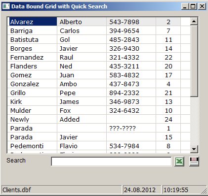

It is very nice Esgici.
In a live software of mine, I have done like this. I have added two more features.
1. If they start typing a number, it will search in 'code' column
2. If no string is matching in the first column, it will start search in next column and so on. (it is like anywhere searching even inside a string)
And, I would add two buttons (like a GridToolBar) to export the contents to Excel (via my Grid2CSV function) and print the contents anytime to the printer (via GridPrint)

This is exactly what I need. You guys are great! Thank you!

Well ...
I'm glad that you liked it :)
Do you like also sharing with us your enhancements ?
