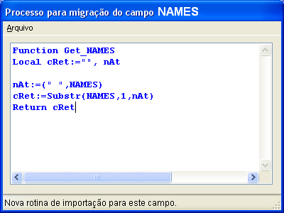

Ohhh you need to see ! When you ckick in "Processos" button, you can apply one specific rule or procedure to take the particular data of new field chenged. This you can write in xBase language.
In this process made by prg text file and being compiled in runtime, you can make to get from another third file to be located and repass to actual field. You can do this in each of all fields even been new or not changed too. it All will depends of you source code written.
Do you understand now ?

1. Lets say that we need to change size and consequently data of field NAMES in Clients.dbf
2. It data must bringing only first name (for exemple)
3. Before changing size of this field with name of "NAMES", you can click in "Processos" button and then will open a window like this:
4. Then you will save this editing codes (with this example) thru menu option "Arquivo" then "Gravar".
5. After this you can make efects clicking in "Salvar" button.
6. Open with your favorite DBF editor then you will see the field "NAMES" just with only first names.
Is it clear now ?

User defined conversion "processos" not working yet, is this correct ?
I'm waiting for translation ;)
STRU - Lists and modifies the structure of the dbfs file
esgici wrote:User defined conversion "processos" not working yet, is this correct ?
Ohh yes it is working ! As I mentioned at my previous message. Remember, you will need to make your own source code inside that EditBox and save your text with "Gravar" in menu item. Then you can "Salvar" just for apply modifications.
