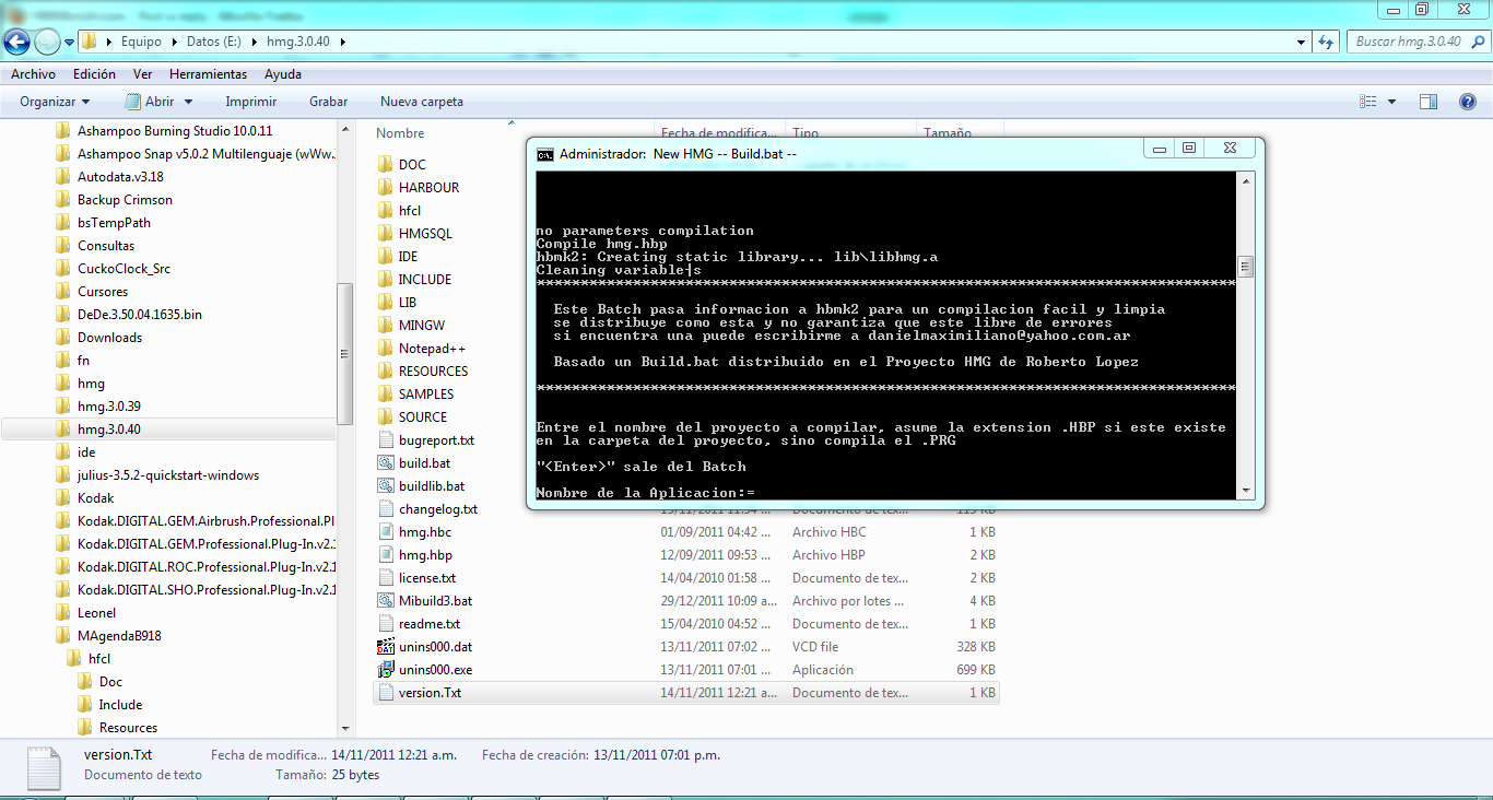

Re: HMG 3.0.40 ( Re-building lib )
Hi All
I can't re-build HMG lib via buildlib.bat :(
C:\hmg>buildlib
Harbour 3.1.0dev (Rev. 17111)
Copyright (c) 1999-2011, http://harbour-project.org/
Compiling 'source\ErrorSys.prg'...
source\ErrorSys.prg(48) Error F0029 Can't open #include file 'hmg.ch'
hbmk2: Error: Running Harbour compiler (embedded). 1
(C:\hmg\harbour\bin\harbour.exe) -n2 source\ErrorSys.prg source\h_browse.prg sou
rce\h_button.prg source\h_checkbox.prg source\h_combo.prg source\h_controlmisc.prg
\ -iC:\hmg\harbour\include
In fact I need no re-build HMG, but my own lib; attempting re-build HMG was for learning new way to build a lib.
Any help will be appreciated.
Re: HMG 3.0.40
Hi Esgici:
recien compile hmg.hbp mediante el batch que modifique para construir mis programas y no encontre ningun error.
puede ud. modificar la ruta donde se encuentre su instalacion hmg.
Translate google:
recently compiled by the batch hmg.hbp to modify to build my programs and found no error.
can you. change the path where the installation is hmg.

Re: HMG 3.0.40
Hola Daniel
Thanks to your interest :)
But my problem is with buildlib.bat, no build.bat :(
Re: HMG 3.0.40
Hi Esgici,
It is working fine for me. Can you please upload/enter your buildlib.bat?
Re: HMG 3.0.40
Hi Rathi
rathinagiri wrote:It is working fine for me.
This is very good news :)
My buildlib.bat is :
@echo off
REM
REM $Id: buildlib.bat 438 2010-10-19 02:37:12Z roblez $
REM
SET HMGPATH=%~dp0
hbmk2 hmg.hbp
