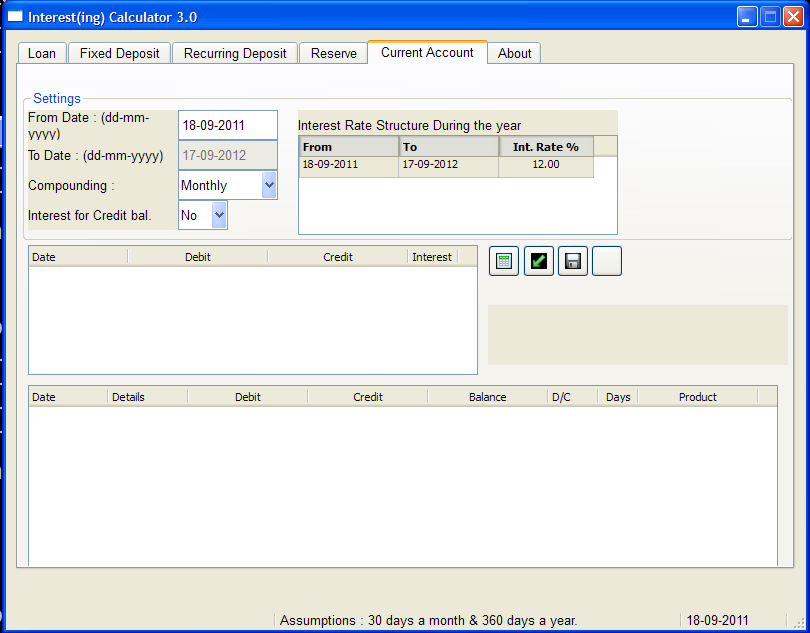

Thanks to your code I found some errors in hmg.ch, in missing keyboard defines, conflicting definitions of MAXIMIZE for windows, missing begin/end ini, execute file, setfocus as a function, events that should be fired later.... but MORE IMPORTANT I found a really dangerous situation: hmg4 uses objects to store its widgets and accesses them (quite) directly, expecially WINDOWs...

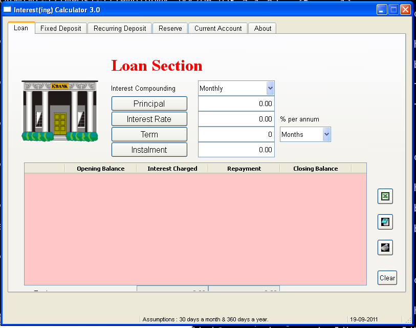

Thanks to the code provided by Rathinagiri I could see some problems in HMG4 and solve them.
Changes in rathinagiri code are:
- remmed begin/end ini
- created a qrc file for icons/images
- rename "interest" variable to not conflict
Now the look is "more complete" but... well, not pleasant...
I see several problems for tab pages:
a) background color of tab page - it may be a Qt problem, should investigate SOLVED, it was a property that HMG4 set to labels
b) coordinate inside the tab page, all the widgets are too low - probably in HMG3 you have other 0,0 reference ?
I updated the image, now only point b) is valid
