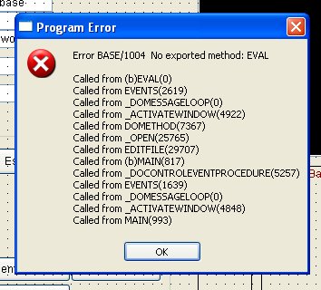

I installed the version 39 of HMG in an Intel Core 2 Duo T6570, Windows 7 Ultimate operating system and also with Windows XP, after performing this installation, I tried to run a project that runs perfectly on a desktop computer with Intel Core2 Windows XP version with the HMG 35, and the following error occurs in the HMG-IDE when I try to put a move componet in the form:
Error BASE/1004 no exported method: EVAL
I wait for help, or even an account of someone who has already gone through this problem.
Thank you.
error base1004.jpg (37.44 KiB) Viewed 8163 times

Hello everyone!
The above error was solucioned to perform the installation of HMG with permission of the Administrator.
Thank you.
