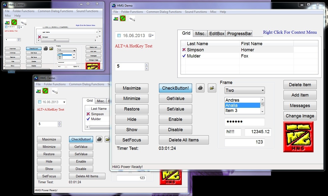

What it does?
1. Basically it doesn't changed the height of TEXTBOX (TEXT), and BUTTON controls.
2. SLIDER and STATUSBAR width, height and font size never changed as well.
Its okay for me to change the width so that it can better fit the desktop width and height based on monitors resolution. However when the height (TEXTBOX, SLIDER, STATUSBAR and BUTTONS) changes the screen looks like it becomes magnified (technically this is correct but some users is not pleased by these kind of effect as a result of the aspect ratio computation).

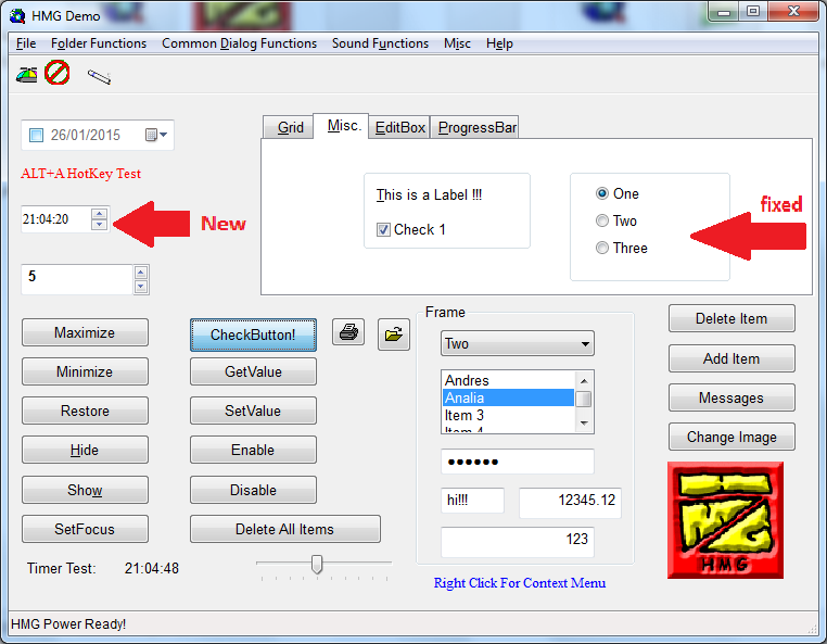

I also added the new TimerPicker control and some others little changes with controls positioning in the sample demo at attached file.

AutoAdjust controls by window resizing

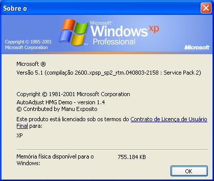

Looking for ShellAbout function present in our HMG library, came again to this topic...
I've noted some bugs and corrected already in C:\hmg.3.4.0\SAMPLES\Basics\MAIN_AUTOADJUST as follows:
  1. Fixed ShellAbout() in Demo.prg
  2. Optimized code in AutoAdjust.prg for RADIOGROUP,TEXT and BUTTON (it's the same treatment)
  3. Be included in Demo.prg new TimerPicker control
In attached here is the improved DEMO for C:\hmg.3.4.0\SAMPLES\Basics\MAIN_AUTOADJUST
