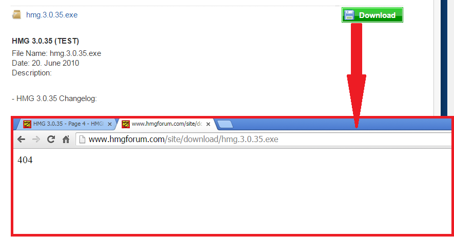

Posted: Mon May 25, 2015 2:05 pm
Roberto Lopez wrote:Download/Descarga: site
Hi Rathi,
Today I tried to make download of this HMG version and links are broken... :(
Any problem in host to get it back again this version ?
HMG 3.0.35
Posted: Wed May 27, 2015 10:04 pm
Hi Rathi,
Hi Rathi,
Any news about it ?
I have made many indications over many other forums regarding this version for the simplest question of console mode and making easier for beginners. So this link I have indicated and many is unable to download this version... :o
Re: HMG 3.0.35
Posted: Thu May 28, 2015 4:10 am
I will check back in the server and revert back.
