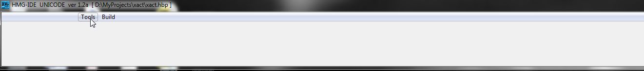

Here happen again at end of night (22:50h). All this end of afternoon working normally upto now. As you can see 34 compilation was realized with IDE 1.2a (I reset the counter).

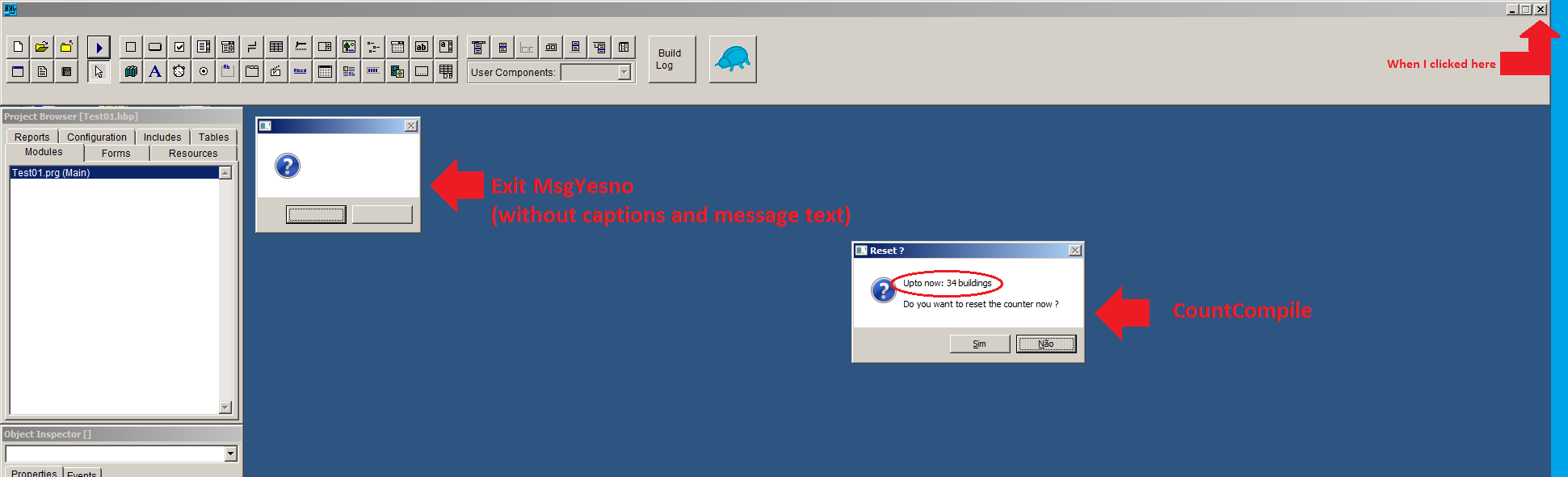

This happen after my last building and when I tried to close it by [x] button is a capture screen below:
If I answer for "No" exit, works properly and all caption, menu items and titles redraw again and clicked on window "Project Browser".

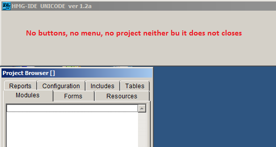

If a click on exit button of IDE, the MsgYesno for Exit, the Msg text is displayed but not when I click [x] button.
If I click "Yes" on exit IDE, it disapear all buttons, all menus and the project name and do not close it. Only by Task Manager to close it.
No messages errors. No log, neither.
