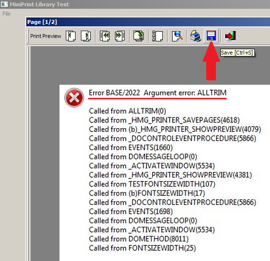

srvet_claudio wrote:
tonton2 wrote:Bonjour,Hi
depuis le patch4 au patch6 il y a apparition de cette erreur lors de la sauvegarde comme indiqué sur l'image.
since the patch4 patch6 there appear this error when saving as showning in the image.
I fixed.
Bonsoir tout le monde,
j'ai remplacé le patch 6 par include et source de HMG 3.4.0 puis BuildAllLib et tout fonctionne de nouveau tres trés bien dans HMG 3.3.1.
Good evening everyone,
I replaced the patch 6 by INCLUDE and SOURCE of HMG 3.4.0 then re-compiling with BuildAllLib and everything works again very very well in HMG 3.3.1.
source_include_doc.340.rar
(2.53 MiB) Downloaded 502 times

HMG 3.3.1 (Stable)
Hi All,
In order to avoid runtime error when click on Save button of this current version of our Print Preview:
Please go to your C:\hmg.3.3.1\SOURCE\h_controlmisc.prg edit file, at Function _HMG_PRINTER_SavePages where is:
LOCAL cFullName, cPath, cName, cExt, cExtFile := ""
please change for:
LOCAL cFullName:="", cPath:="", cName:="", cExt:="", cExtFile := ""
Then you will need to rebuild libs by executing C:\hmg.3.3.1\BuildLib.bat.
Keeping update... :)
