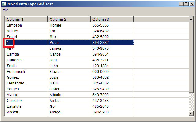

The property COLUMNVALID in Grid, makes a validation during the cell is still active. The problem I wish to change value of this cell in this validation function. But can't be changed... :(
You can see C:\hmg.3.3.1\SAMPLES\Controls\Grid\GRID_14\demo.prg and Test() function there, is not working... :(
But if you make the same test at C:\hmg.3.3.0\SAMPLES\Controls\Grid\GRID_14\demo.prg works normally !!!
I think there is a bug in GRID around _SetItem().
Please, someone can confirm this ? Can anybody make this test for me ?

In the previous version 3.3.0 it's working, see at first column when we left empty what's happen:
In my PC the 3.3.1 is not working...

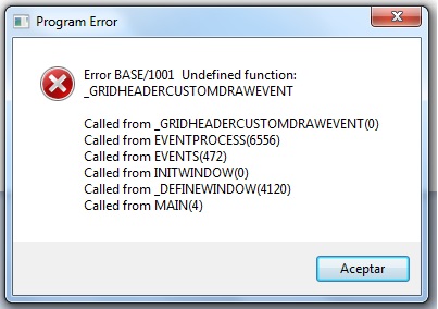

Después de sustituir los archivos el IDE no trabaja y en todos los archivos que quiero compilar con el IDE me sale este error.
Hello everyone
After replacing the IDE files does not work and all the files you want to compile with the IDE I get this error.
Re: HMG 3.3.1 (Stable)
Y también me sucede lo mismo con Build.bat

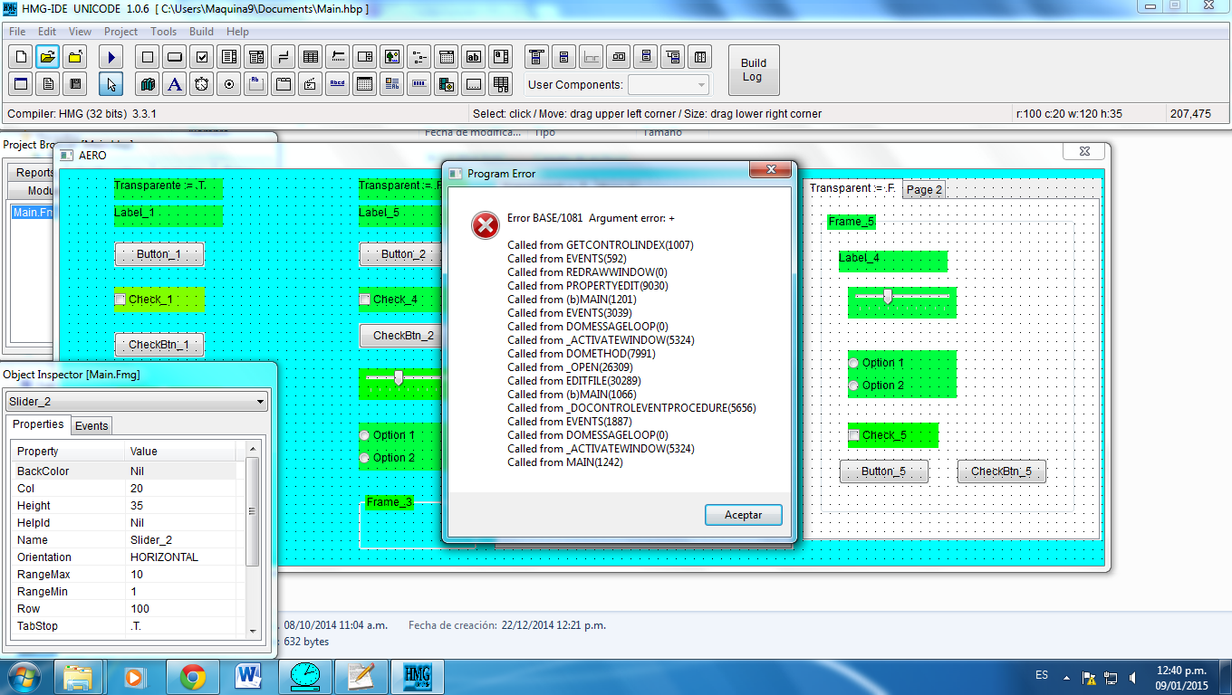

También quiero informar que el control Slider cuando esta en un Tab y le quiero poner BackColor a "NIL Default" me da el siguiente error:
También probe con: CheckBox, RadioButtons, Label, TextBox y si funcionan bien. Solo Slider es el que da error. Alguna idea?
Hello everyone,
I replaced Release of HMG, Ultimo Patch. without the above two files.
I would also like to report that the Slider control when in one Tab and you want to put BackColor to "NIL Default" gives me the following error:
Also probe with: CheckBox, RadioButtons, Label, TextBox, and if they work well. Only Slider is giving error. Any ideas?

Javier, after replaced files, have you rebuilded HMG lib ?
srvet_claudio wrote:Please, change INCLUDE\i_this.ch and SOURCE\h_grid.prg files for these new files, and rebuild the lib.
