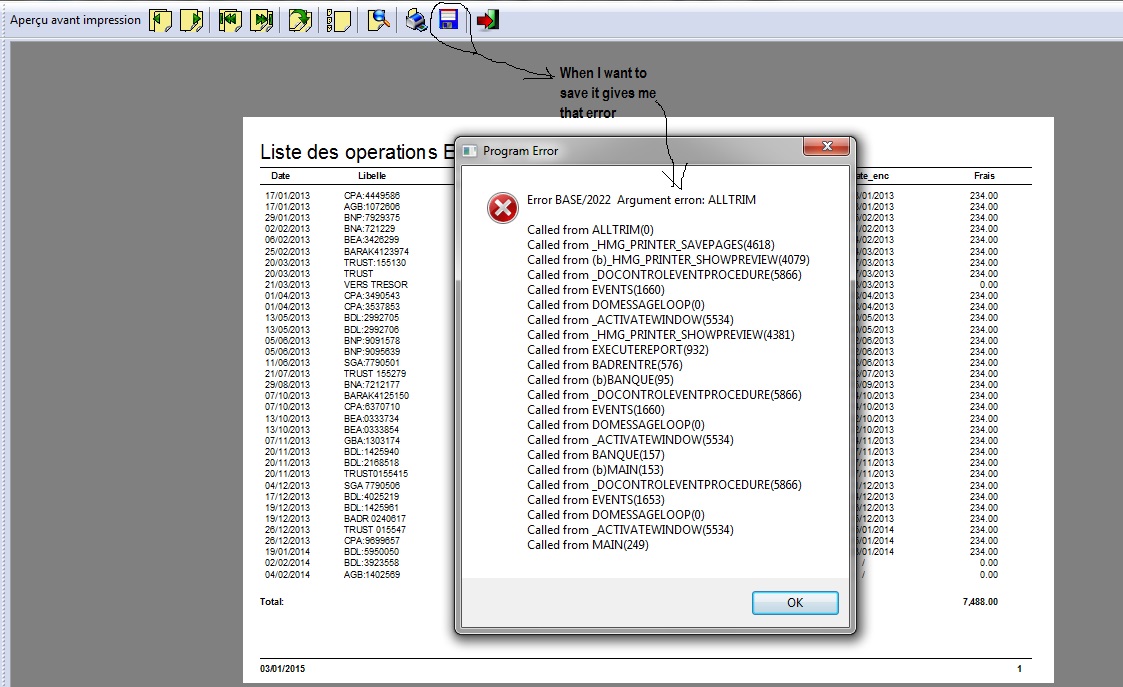

Bonjour,Hi
depuis le patch4 au patch6 il y a apparition de cette erreur lors de la sauvegarde comme indiqué sur l'image.
since the patch4 patch6 there appear this error when saving as showning in the image.

tonton2 wrote:Bonjour,Hi
I fixed.
I fixed.
Bonjour,
Please ,I dont understand how you fixed it
merci beaucoup
I fixed.
Good morning
please Dr Claudio , You wrote that you have fixed that error, but I can't find where is the solution, or I didn't undestand what you wanted to say
Grand merci
I confirm existing of this error.
