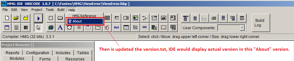

Ummm now I see the main problem about patches release.
Normally we have HMG version thru C:\hmg.3.3.1\Version.txt file. But when is released patches, this has not been updated.
For HMG Development Team: IMHO, (suggestion) would it be good to send a new Version.txt and if is possible to send also changelog.txt too. :idea:
I also suggest to modify IDE in "About" option's contain. (See picture below)
Thank you Claudio Tedesco for advising about this difficulty.
