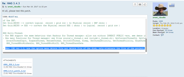

Hello,
After applying the two patches and making buildAlllib, I have this error at compilation:
Harbour 3.2.0dev (r1601151502)
c:/hmg.3.4.3/lib\libhmg.a(c_richeditbox.o):c_richeditbox.c:(.text+0x15a9): undefined reference to `IsRichEditBoxVer30'
gcc.exe C:/Users/CHRIST~1/AppData/Local/Temp/hbmk_k4dhzt.dir/Annuaire.o C:/Users/CHRIST~1/AppData/Local/Temp/hbmk_k4dhzt.dir/hbmk_69gc9f.o G:/Programmes/AnnuaireV1.0.5/_temp.o -pthread -static -lpthread -mwindows -Wl,--start-group -lhmg -lcrypt -ledit -leditex -lgraph -lini -lreport -lhfcl -lmsvfw32 -lvfw32 -lhbmysql -lmysql -lhbfimage -lhbpgsql -lsddmy -lhbvpdf -lhbct -lhbwin -lhbmzip -lminizip -lhbmemio -lhbmisc -lhbtip -lsqlite3 -lhbsqlit3 -lsddodbc -lrddsql -lhbodbc -lodbc32 -lhbhpdf -lhbnetio -lxhb -lpng -llibhpdf -lhbzebra -lhbextern -lhbdebug -lhbvmmt -lhbrtl -lhblang -lhbcpage -lgtcgi -lgtpca -lgtstd -lgtwin -lgtwvt -lgtgui -lhbrdd -lhbuddall -lhbusrrdd -lrddntx -lrddcdx -lrddnsx -lrddfpt -lhbrdd -lhbhsx -lhbsix -lhbmacro -lhbcplr -lhbpp -lhbcommon -lhbmainwin -lkernel32 -luser32 -lgdi32 -ladvapi32 -lws2_32 -liphlpapi -lwinspool -lcomctl32 -lcomdlg32 -lshell32 -luuid -lole32 -loleaut32 -lmpr -lwinmm -lmapi32 -limm32 -lmsimg32 -lwininet -lhbpcre -lhbzlib -Wl,--end-group -oAnnuaire.exe -Lc:/hmg.3.4.3/harbour/lib/win/mingw -Lc:/hmg.3.4.3/lib
Re: HMG 3.4.3
chrisjx2002 wrote: Mon Mar 20, 2017 11:45 am Hello,
Thanks for report, in line 693 of file source/c_richeditbox.c
change:
if ( !IsRichEditBoxVer30() )
For this:
if ( ! HMG_IsRichEditBoxVer30() )
