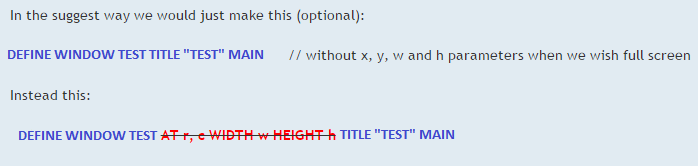

srvet_claudio wrote:..//.. the functions GETDESKTOPREALTOP, GETDESKTOPREALLEFT, GETDESKTOPREALWIDTH and GETDESKTOPREALHEIGHT, these functions are parts of HMG.
That's means you have already implemented synthesized way for windows creation in full screen by default ?
In other words, now we can just to DEFINE WINDOW without row, col, width and height parameters then it will be considered at full screen windowed according Desktop sizes.
Once again, thanks Claudio !
Re: HMG 3.3.1 (Stable)
Thank you Dr. Claudio for nice improvement, it is really simplified
