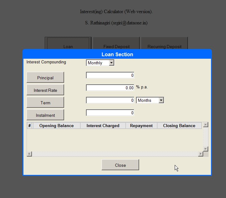

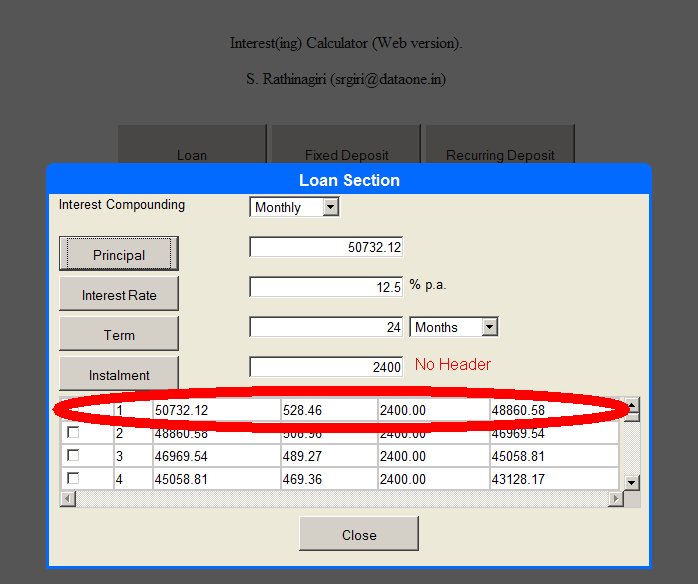

Re: HMGSCRIPT 2012: Programming For The Web in The Right Way
Thank you Roberto.
I have started using this for my Interest(ing) Calculator (web version) :)
Now, some of the problems I have encountered:
1. When deleting all the rows in a grid, the header is also removed.
Before:
After:
2. Scope of variables is a problem. I can't use variable name 'n' because it is used inside Grid part of library. It is changed.
Some feature requests too:
1. Justification of columns inside a grid.
2. Numeric textbox.
rathinagiri wrote:Thank you Roberto.
Thanks for the report.
1. If you look at the sources, you'll note that the table header is added as a row (it is effectively a row), so you must take care of it when deleting all.
2. You are right. I must to take care of variable scopes. I'll do for the next release.
