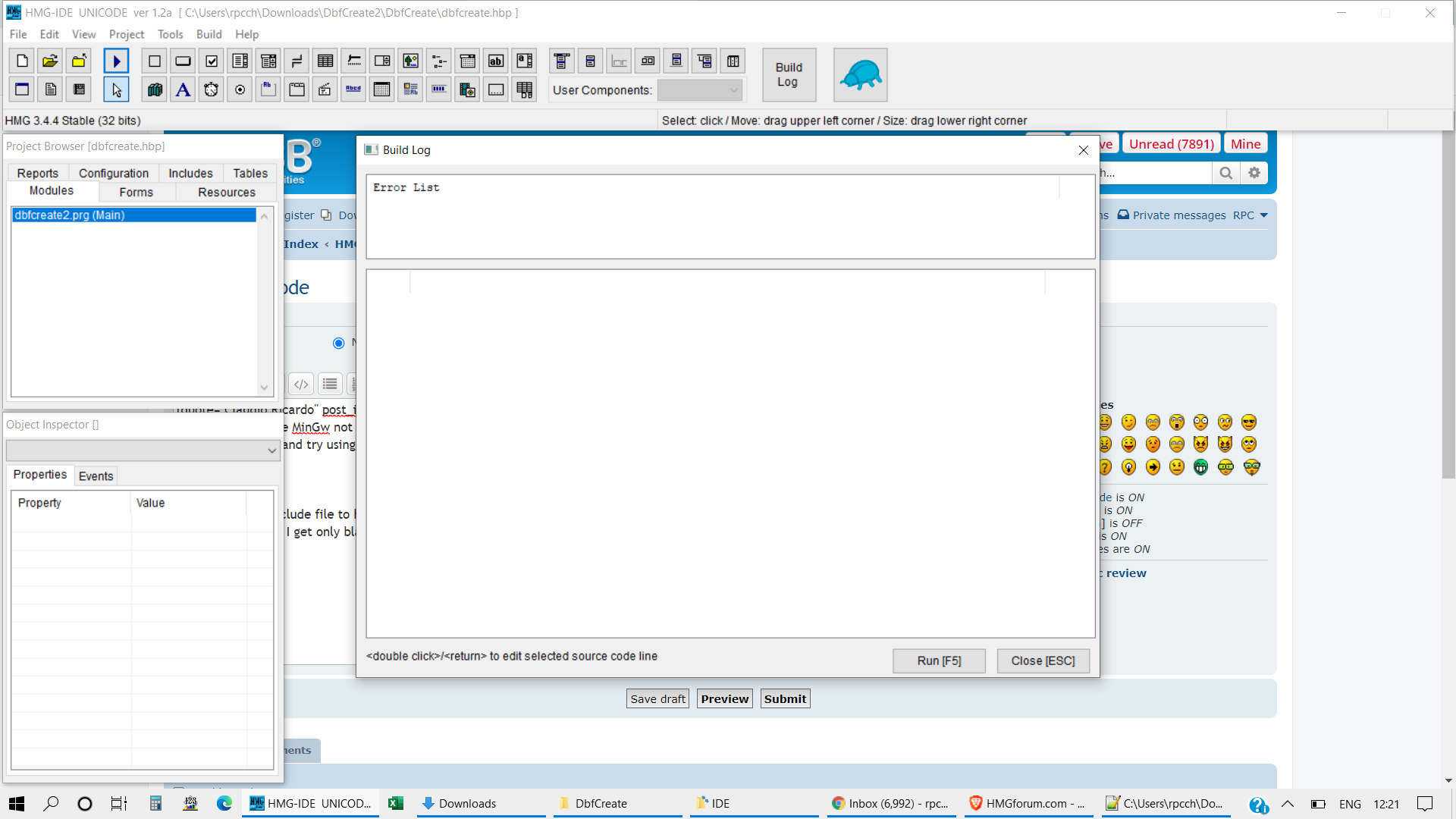

I tried changing include file to hmg.ch and compiled using HMG.IDE .
It doesn't compile. I get only blank window as per attached ss.
I am actually confused, will it compile by HMG or HMGExtended because the zip file contains both dbfcreate.hbp and dbfcreate.hpj
DBFCreate Error HMG.IDE.png (194.89 KiB) Viewed 2861 times

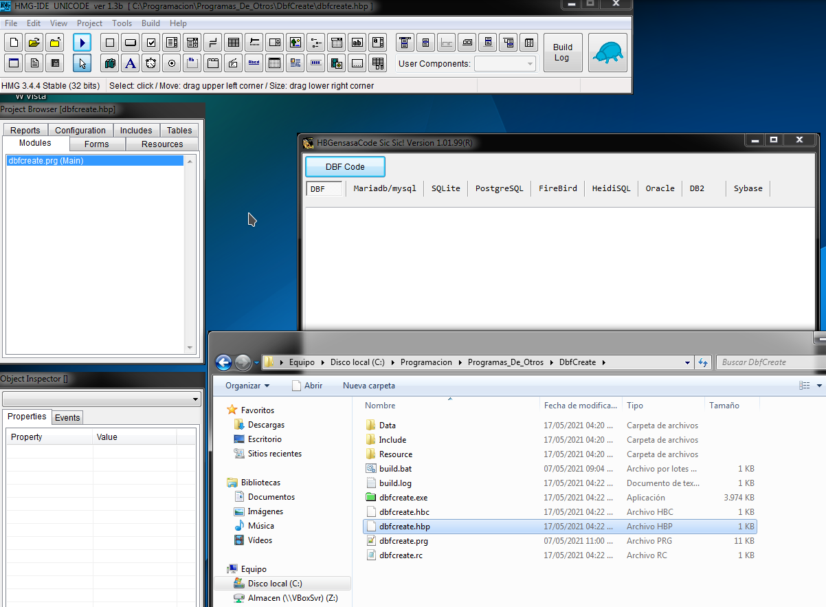

Hi ... I downloaded it, Unzip, Move to one work folder, opened the file "dbfcreate.hbp" and compiled without any error (I did not alter any files)
I downloaded the last file posted and I did not find any .hpj file inside the .zip
Maybe the .zip got corrupted while downloading it, or you need to run HMG as admin. (No use "build.bat" you can delete it)

It seems seeing '#include <minigui.ch>' I myself created hpj file(and then forgot about it) and was trying to compile it in HMGExtended. There was no need to go for HMGExtended and it compiles in HMG.
