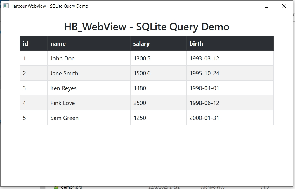

Hi all,
I have added a new demo (demo5.prg), a SQLite query where the results are displayed in an HTML table.
Download code from: https://www.hmgforum.com/viewtopic.php?p=71617#p71617
