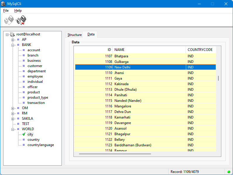

I tried to rewrite the MySqlCli example of Minigui using the SQLRDD library.
You can see the result of this program in the picture below:
Your feedback is welcome. :)
