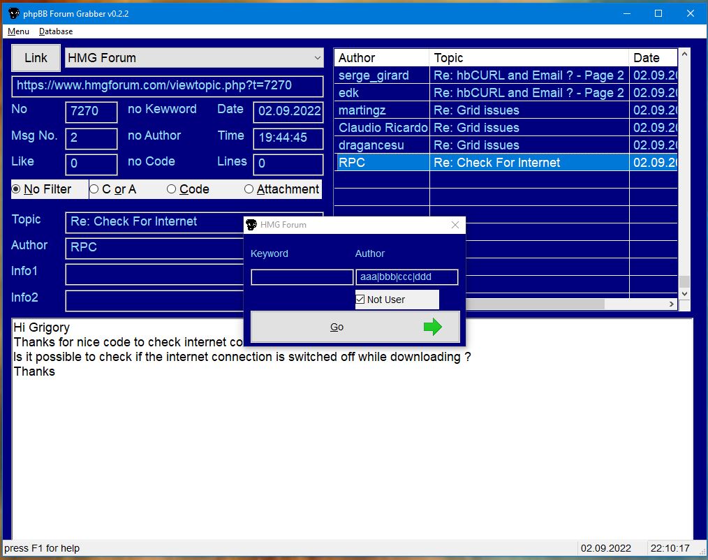

have notice that i miss Window for "Setup" DBF ... so i add it in Menu
it will take some Time to finish it so i will release Source later.
here latest Version where "Speed" was fixed ( remove !DELETED() )
FORUMHMG_49.zip
(1.72 MiB) Downloaded 397 times
add :
add Index TAG "MSGDATE" (please delete old FORUM.CDX )
add new in CONFIG.INI (please delete old CONFIG.INI)
add more HTML to "remove" (please delete old HTMLSIGN.DBF)
add Setup Window for FORUMDIR.DBF, HTMLSIGN.DBF, NOTUSER.DBF and (new) COLOR.DBF
add Transparency for Child Window when "LOSTFOCUS"
add save new Layout in CONFIG.INI while running (need open Windows to get Row/Col and Size)
btw. for FILTER you can use "|" (pipe) for more than 1 Author ... or "exclude" them
press F9 will "load" User from NOTUSER.DBF which belong to "active" Forum

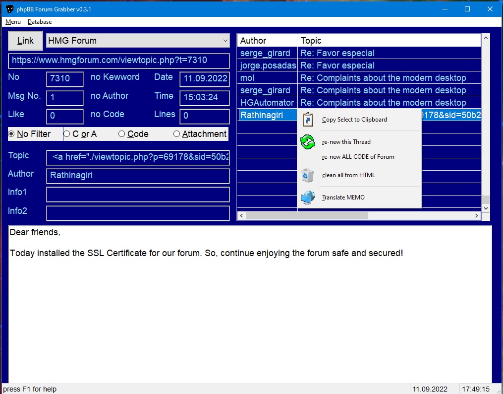

Re: HMG Forum "Codebox" Reader
here latest Version v0.3.1
FORUMHMG_57.zip
(1.73 MiB) Downloaded 382 times
v0.2.5 BUG MsgNo when not "in Order" -> DoCleanBody()
v0.2.6 DoReNewMsg() : all Message of same Thread
v0.2.7 DoMethod( "FORUM", "Browse_Main", "SetFocus" )
v0.2.8 Forum Combobox ONENTER -> ON CLOSEUP
move "Transparency" into ShowMemo
v0.2.9 DLALLCOD.PRG : get all CODE again
v0.3.0 Layout/Resize for all "Edit" Window
v0.3.1 CheckForumDir(), SnapToCtrl()
p.s.
ForumDir.DBF will be automatic "upgrade" new Structure ( add "THREADSIGN", "C", 10 )

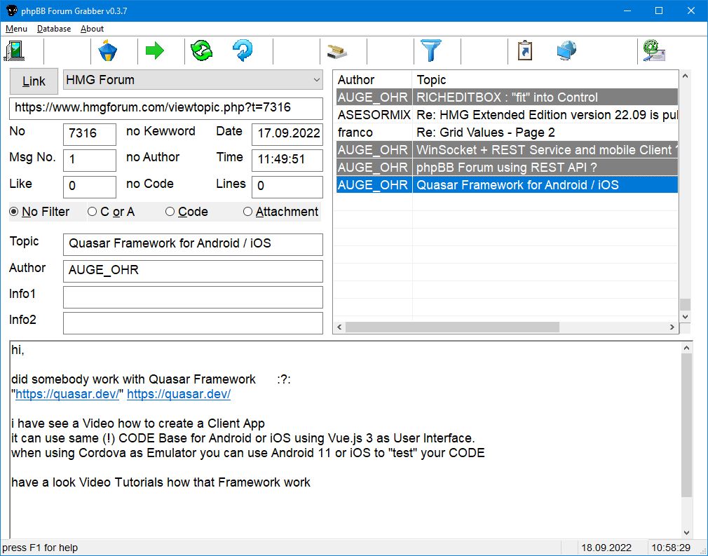

latest Version better for Table PC with Toolbar ( Option /T )
RTF now "fit" into Control Width
// 12.09.2022 v0.3.2 DownloadRange() change Index TAG "MSGDATE" -> "DUPECHECK"
// 13.09.2022 v0.3.3 EofBody(@cBody)
// 14.09.2022 v0.3.4 "DOS Error 32" when App "hang" in Tasklist
// 15.09.2022 v0.3.5 Net_Use()
// hb_Translate( oError:Description, cTranslateCP+"WIN" )
// 16.09.2022 v0.3.6 RichEdit_Body : HSCROLL .T. -> WordBreak RTF Width
// Debug Files -> GetThreadFileName(cWorkPath, nThreadNo )
// 17.09.2022 v0.3.7 Option /T -> Toolbar for Touchpad
FORUMHMG_62.zip
(1.77 MiB) Downloaded 401 times

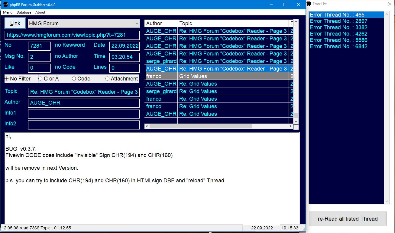

BUG v0.3.7:
Fivewin CODE does include "invisible" Sign CHR(194) and CHR(160)
will be remove in next Version.
p.s. you can try to include CHR(194) and CHR(160) in HTMLsign.DBF and "reload" Thread
next Version with BUG Fix
// 18.09.2022 v0.3.8 more Cursor (WAIT) and Icon for SayBarText()
// 19.09.2022 v0.3.9 DoErrorLog() -> ListLog( aError )
// 20.09.2022 v0.4.0 FiveWin : remove CHR(194) and CHR(160) in CODE
// 21.09.2022 v0.4.1 after CODE Rest of BODY is missing
// 22.09.2022 v0.4.2 IsInternet()
// 23.09.2022 v0.4.3 Translate FromClipBoard()
// 24.09.2022 v0.4.4 new Forum "Deskmodder" (German Hardware Forum)
FromClipBoard()
when BODY have BLOCKQUOTE there might be Sign where Google Translate fail
you can mark it in BODY and copy it to Clipboard
when Translate Window is visible and have Focus (!) use CTRL + V and paste it from Cipboard
it will translate what come from Clipboard
ListLog()
will get Error when download Message.
it will use MessageBoxTimeout() and NOT "stop" download
later it will show Dialog where you can re-read missing Message
FORUMHMG_69.zip
