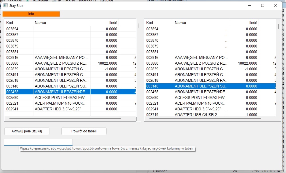

Re: Row BackColor in inactive BROWSE control
Hi!
I'm attaching .prg and .dbf to test this solution.
I've copied some functions from HMG library source to not modify it.
On the picture left table is a browse control, right - grid
