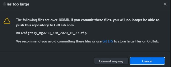

Hi,Rathinagiri wrote: ↑Sun Nov 15, 2020 7:40 pm Regarding the HMG 3.5, I have used the nightly build of Harbour. Do you want to update the same in github also?
I tried to upload the nightly file but github denied me access to do that because of the size of the file.
Today I generated the latest version of harbour
and the difference with the nightly version is the addition of the dll files and the mingw compiler.
The built-in mingw compiler is version 7.30, outdated.
This is the package generated today ( without dlls and mingw ) if you want to compare them.
https://github.com/asistex/hmg_tools_co ... _11_15.zip
Available In the next Pull Request.
With those dlls we can create a separate package. I don't know how necessary they are for hmg.
