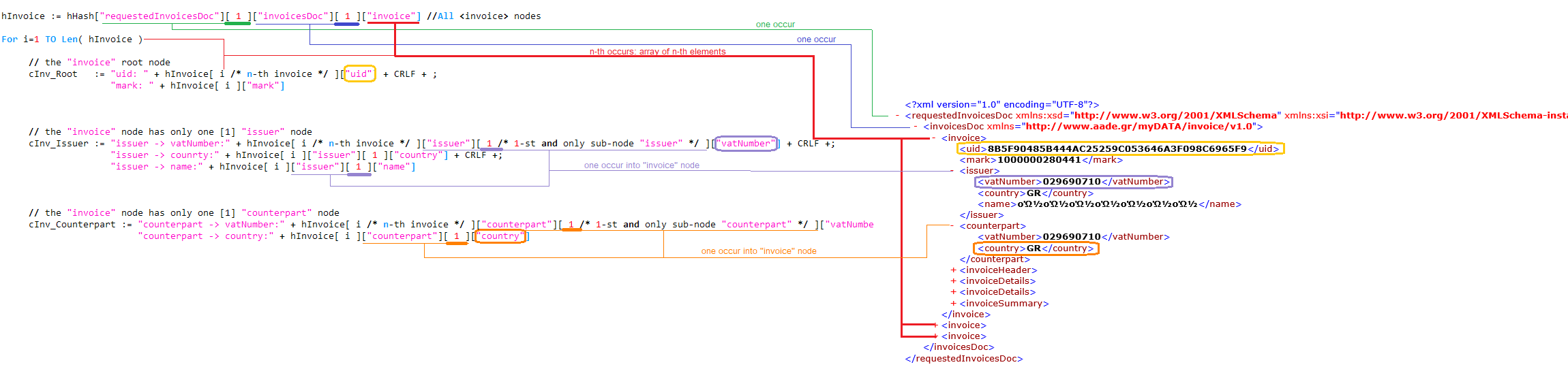

Re: Login to website
Posted: Wed Sep 25, 2019 6:30 am
by tomtagaris
SOMETHING ELSE EDK
I USE THE SAME PROCEDURE TO PROVIDE DATA FROM THE XML FILE RETURNED WITH RequestInvoices BUT I DON'T GET ANYTHING
WHAT I DON'T DO right
cXml := ohttp:ResponseBody()
pRoot := mxmlLoadString( NIL, cXml, MXML_OPAQUE_CALLBACK )
hHash := XMLtoHash( pRoot, /* start from root node */ )
mxmlDelete( pRoot )
hResponse := hHash["invoicesDoc"][2]["invoice"] //All <response> nodes
For i=1 TO Len( hResponse )
MsgInfo( "uid: " + hResponse["uid"] + CRLF + ;
"mark: " + hResponse["mark"] + CRLF + ;
"vatNumber: " + hResponse["vatNumber"] + CRLF + ;
"mark: " + hResponse["mark"] , hb_NTOS(i) + " response" )
next i
the returned xml

Hi Tom.
I see you have a problem understanding the hash array structure.
Unfortunately, my English is not very good to explain, so I made a pictorial description. I hope it will be helpful.
Bez tytułu.png (55.27 KiB) Viewed 7671 times
Source code below:
hInvoice := hHash["requestedInvoicesDoc"][ 1 ]["invoicesDoc"][ 1 ]["invoice"] //All <invoice> nodes

I split hHash into individual variables to make the structure easier to understand.
Edward.
