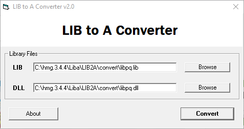

Re: LIBhmg-64.a / LibLibPq-64.a
Libpq.lib and libpq.dll are the libs that are in the 64 bit postgresql installation
the library was converted with the Lib to a recommended by friend Claudio Soto in viewtopic.php?t=4641C:\Program Files\PostgreSQL\11\lib
THX so i can make next try
*.DEF file look good so i copy liblibpq.a into c:\hmg.3.4.4\LIB-64\Liblibpq-64.a
start F5 and got
so i try to convert "my" 64 Bit libpq.dll libpq.lib and it work but i got same Result
before run i found some file in \Convert and they include "32" in Name and i check DLL and it was 32 Bit ... hm
is it possible that Converter work for 32 Bit only
as other have download it too please write if it work in your Environment under 64 Bit, thx
start F5 and got
Harbour 3.2.0dev (r1604201603)
Copyright (c) 1999-2016, http://harbour-project.org/
C:/hmg.3.4.4/mingw-64/bin/../lib/gcc/x86_64-w64-mingw32/5.3.0/../../../../x86_64-w64-mingw32/bin/ld.exe: skipping incompatible C:/hmg.3.4.4/lib-64\liblibpq-64.a when searching for -llibpq-64
C:/hmg.3.4.4/mingw-64/bin/../lib/gcc/x86_64-w64-mingw32/5.3.0/../../../../x86_64-w64-mingw32/bin/ld.exe: skipping incompatible c:/hmg.3.4.4/LIB-64\liblibpq-64.a when searching for -llibpq-64
C:/hmg.3.4.4/mingw-64/bin/../lib/gcc/x86_64-w64-mingw32/5.3.0/../../../../x86_64-w64-mingw32/bin/ld.exe: cannot find -llibpq-64
hbmk2[PGTEST]: Error: Running linker. 1

i still don't know why i can't get it work. LIB2A seems for 32 Bit while "skipping incompatible"
but i got a Step for 64 Bit
