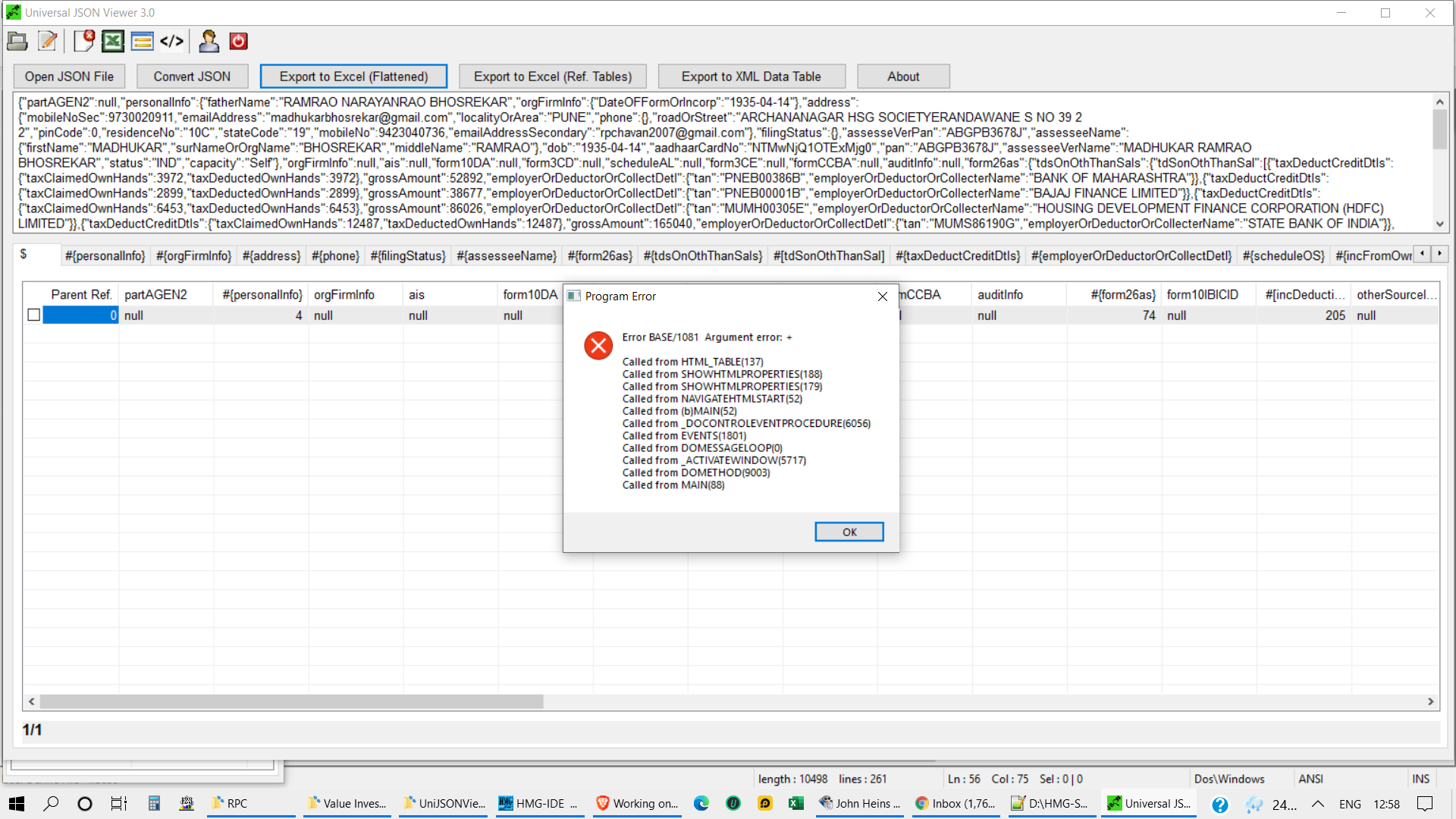

Hi Rathinagiri
I am trying to use HBJson/UniJsonViewer to convert Json file to Excel file. I am getting following errors.
When I try to convert to Excel(Flattened)
HMG Error UniJason2XL(Flattened).png (564.84 KiB) Viewed 5964 times
When I try to convert to Excel(Ref Tables)
HMG Error UniJason2XL(RefTable).png (571.84 KiB) Viewed 5964 times
When I try to convert to XML
HMG Error UniJason2XML.png (558.89 KiB) Viewed 5964 times

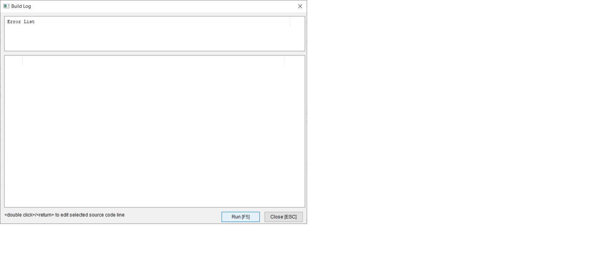

Finally I tried to compile json.hbp and got following blank screen.
HMG Error HBJason.png (22.95 KiB) Viewed 5964 times
I think Sudip has reported the same blank screen in immediate above post.

Hi Rathinagiri sir
I am still getting blank screen on compilation as shown in my post earlier.
I am using HMG 3.4.4 my os is win 10 x64
thanks
