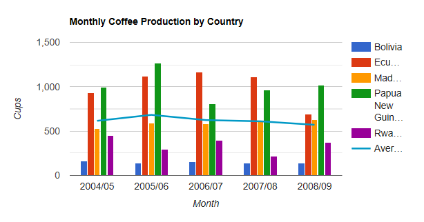

Edward's sample is working like a charm, but when i modified a combo chart, then does not appear the generated html.
GoogleChart.html file is ready and appears in browser.
What could be the problem?

Posts: 1177
Re: OT: API Google crear gráficas
Hi friend minr
replace these lines
* cHtmlString += "<html>" + CRLF
* cHtmlString += "<head>" + CRLF
for this line of code
cHtmlString += '<html>  <head> <meta http-equiv="X-UA-Compatible" content="IE=edge" />  <meta charset="utf-8">' + CRLF + '<!--Load the AJAX API-->'  + CRLF
This is working well
View
viewtopic.php?f=24&t=5718&start=10

mlnr
Posts: 129
Joined: Fri Aug 28, 2015 1:52 pm
Post by mlnr »
Hello Mustafa,
Great!
It really works, thank you so much.
