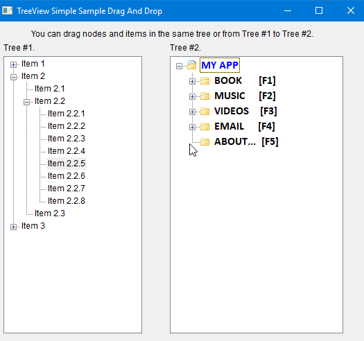

Hi Marek. Just as I thought without C, it would not work.
I have made the TreeView_HitTest function, it returns the value of the handle of the tree node/item on which the mouse pointer is located. :geek:
In the attachment you have a sample using DragAndDrop on trees. You can move nodes/items within a given tree or drag from tree #1 to tree #2.
What I lack in using a tree is the insertion method "InsertItem" ;) .
The "AddItem" method adds items at the end of the node. To simulate the insert method, you would have to save the node structure, insert the item in the saved structure in the right place, delete the node and add item by item in its place. :idea:
Tree DragAndDrop.gif (34.8 KiB) Viewed 19749 times
DragAndDrop_0.005.7z
(9.37 KiB) Downloaded 432 times
