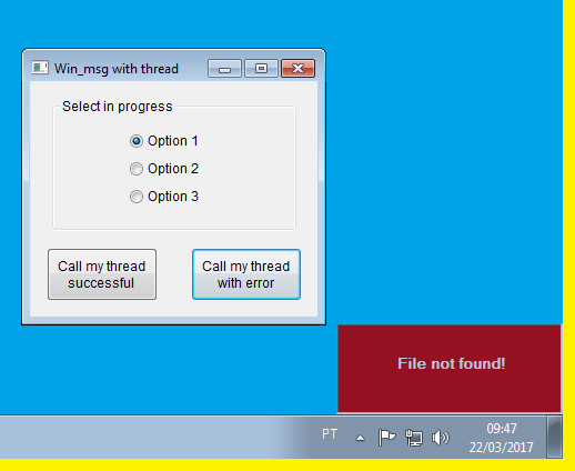

Improvement in notifier message demo.
<Attached file was removed due is a improved version more ahead of this same topic>
Thanks to Dr. Claudio whom has left HMG compatible with Harbour's threads functions.
To see the power of hb_Thread ... and HMG together, you click on button and sudly during notifier (small window) is displaying, you can continue iby clicking in the radiogroup simulating running your app, other screens and process without interferations.
So cool. Thank again Dr. Claudio Soto !

Win_Msg - A kind of Notification message so easy and friendly Demo
Posted: Wed Mar 22, 2017 12:53 pm
Pablo César wrote: Wed Mar 22, 2017 12:08 am Probably make an event function, could be posible.
The problem I'm encountering is that the window is not activated. It is lost after finishing the exposure. Soon I do not think events would be unavailable.
Is it right Dr. Claudio ?
I changed the GetDesktopWidth()/GetDesktopHeight() functions to GetDesktopRealWidth()/GetDesktopRealHeight().
It got better. :D
Win_Msg.rar
Source files - Demo3 (version 1.4)
(2.22 KiB) Downloaded 298 times
This is well attached to the most bottom and most right side of the desktop.
GetDesktopRealHeight() returns the desktop height minus the height of TaskBar.
I also learned that this small non-registered window, we can not capture thru common way (Alt PrntScrn).
Probably is because is not registered window.
Thank you Claudio for providing us with new features in HMG.
I'm really thankful. :)
P.S.: My tip for capturing screens when it is not possible then use this: %windir%\system32\SnippingTool.exe (Capture tool)
