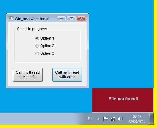

Improvement in notifier message demo.
<Attached file was removed due is a improved version more ahead of this same topic>
Thanks to Dr. Claudio whom has left HMG compatible with Harbour's threads functions.
To see the power of hb_Thread ... and HMG together, you click on button and sudly during notifier (small window) is displaying, you can continue iby clicking in the radiogroup simulating running your app, other screens and process without interferations.

I changed the GetDesktopWidth()/GetDesktopHeight() functions to GetDesktopRealWidth()/GetDesktopRealHeight().
It got better. :D
Win_Msg.rar
Source files - Demo3 (version 1.4)
(2.22 KiB) Downloaded 297 times
This is well attached to the most bottom and most right side of the desktop.
GetDesktopRealHeight() returns the desktop height minus the height of TaskBar.
I also learned that this small non-registered window, we can not capture thru common way (Alt PrntScrn).
Probably is because is not registered window.
