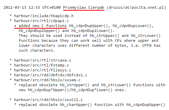

I do not know well if this would helps to you in HMG_UPPER case:
Or if these C functions are acting under ANSI mode with UTF8 because cdp parameter.
Please check: hb_cdpnDupUpper(), hb_cdpnDupLower(), hb_cdpnDup2Upper(), hb_cdpnDup2Lower() or hb_strUpper() and hb_strLower()
ADDED LATER:
These other C functions: hb_strncpy(), hb_strncpyLower(), hb_strncpyUpper()
