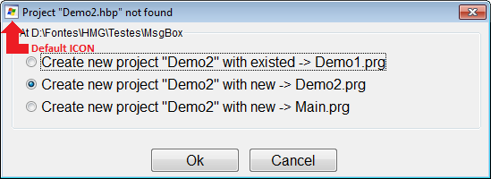

I think we can add an optional parameter giving chance to include personalized ICON at this window of OptionBox()
But do not forget to:
  1. Remove NOSYSMENU at DEFINE WINDOW OPTIONBOX
  2. Change LOCAL cParentWindowName, nRet for LOCAL cParentWindowName, nRet: = 0 based on Theo example
  3. Add the 5th parameter and variable for ICON name
  4. Add ON RELEASE (nRet := 0) to the end of DEFINE WINDOW OPTIONBOX
  5. Changed MODAL by TOPMOST
  6. To fix Cancel option at line after Function OptionBox_Cancel(nRet) add nRet := 0.
    Otherwise always will wrong return the value of RadioGroup (never as zero) :|
To insure us about the changes, please review the attached example:
<Attached file was removed due there is a newest version ahead this topic (fixed bug)>
I hope you like it. :)
OptionBox()
Posted: Mon Jan 23, 2017 5:26 pm
There was two bugs due removing NOSYSMENU and missing pass variable as reference (@).
Button "x" for exit form interferes when be cRet equal to zero or when is valid radioGroup value.
So, I have disabled this button with:
SetProperty("OPTIONBOX","NOCLOSE",.T.)
And also was fixed/added OptionBox_Ok(@nRet) due cRet now is not PRIVATE as Theo has recommended.
Here's fixed version:
MsgBox.rar
Executable and source files
(1.24 MiB) Downloaded 314 times
Sorry for my mistake.
