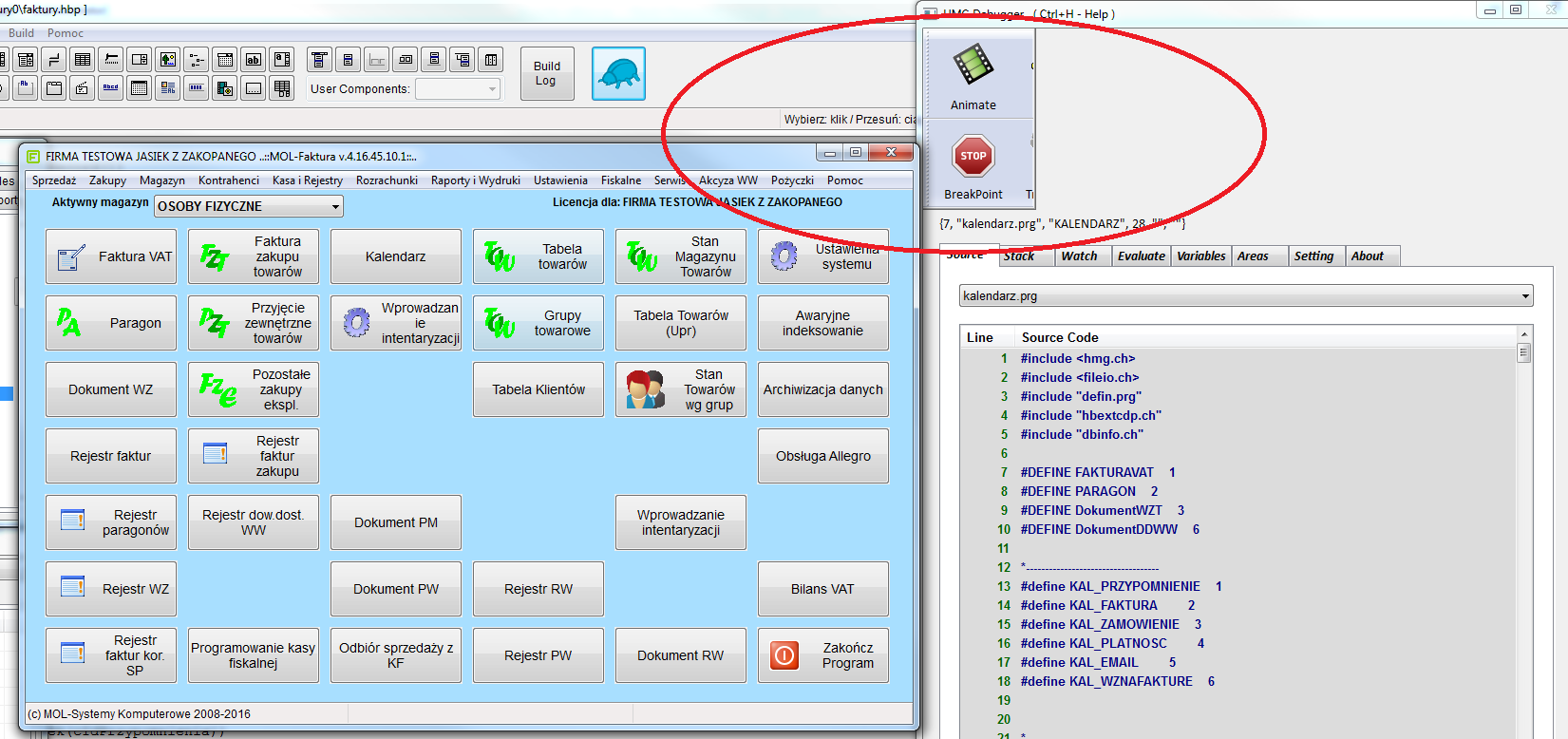

Estas utilizando compilacion incremental?
Posts: 3805
Re: HMG 3.4.3
srvet_claudio wrote: Marek,
Please show me your code in the line:
ZDEFINIUJMENUGLOWNE(2118)

Posts: 3805
Re: HMG 3.4.3
What happened with debugger in this new version?
Re: HMG 3.4.3

mol wrote:What happened with debugger in this new version?
It is a problem of repainting the main debugger window when it appears for the first time, if you maximizes or minimizes the debugger window redisplay ok.
Change line 1494 of file source\debugger\dbgGUI.prg
#if 1
for this
#if 0
and rebuild HMG lib.
